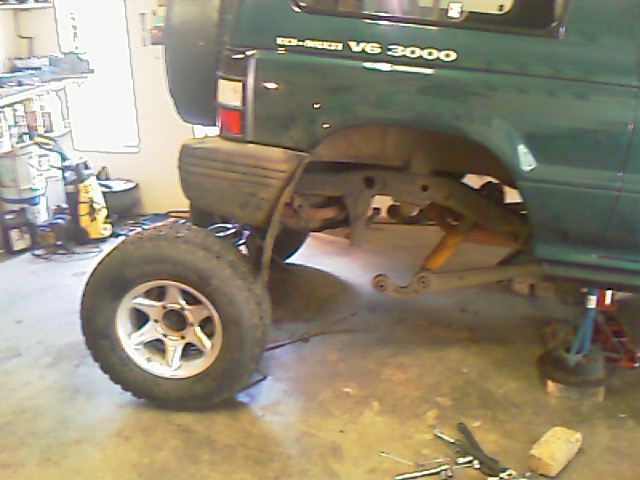

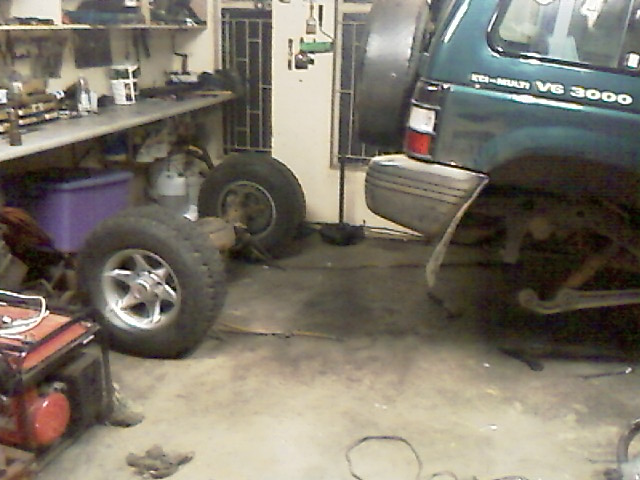

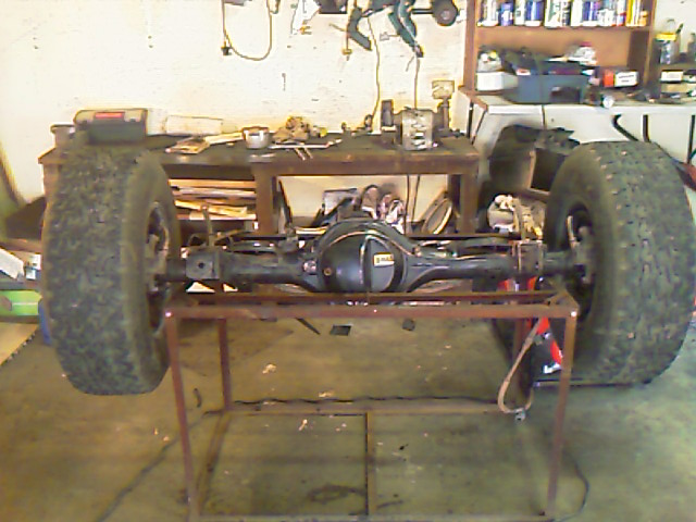

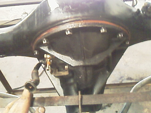

This weekend I fitted a different rear axle (Diff) to mine. The diff was from a LWB from which I removed the LSD centerportion, and fitted a lock diff centerportion. The reason why did not fit the lockdiff centerportion to my current diff is because the amount of holes differ SWB has got 10 and the LWB has got 12. Then I also discovered that the side shafts of the LWB is thicker. I also had to shorten the left side shaft by 16mm to fit on the difflock centerportion. The companion flange connecting the diff to the propshaft also differs in two ways, the splines for the SWB are smaller than for the LWB and the holes for the propshaft is on a different PCD.
All and all it is not such a big job and if I had to to it again I could probably finish it in a day.
I think the way "Vaya123" did it is the easier way if you can get your hands on one of this very rare blister fender SWB diffs.

Hey Jaco – How long did it take to fit the diff (out of interest sake)? Looks like you have done a really nice job!Jaco Vosloo wrote:This weekend I fitted a different rear axle (Diff) to mine.
Well I was doing it all alone. Friday from 4pm to 9:30pm and Saturday from 7am to 15:30.TRay wrote:Thanks Gerrit, just the answer I was looking for.Gerrit Loubser wrote:Yes. The Gen 3s with a rear diff lock actually have a Torsen diff in the rear that can also be locked. The Torsen diff is a gear-type limited slip diff.
Another way to realise a lockable LSD is to use some mechanical means of modulating the pressure on the friction plates of a friction-type LSD. In the center and rear differentials of the Disco 3, Land Rover have used a worm gear driven cam system to achieve this. These Disco 3 diffs can vary smoothly from being open through being LSDs to being fully locked, all under electronic control.
This excludes the time to check the diff backlash and shortening the side shaft and drilling new holes into the companion flange. (I have done this last weekend)
This is basically taking the old one out swap the brakes and put the new one in.
The most difficult part is to jack the car up high enough to get the wheels rolling freely out underneath the rear bumper.
It would also have helped if the car was clean before i started. Sand continuously falling into one’s eyes
