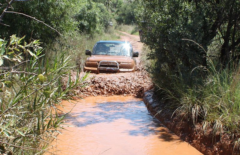

Keep a bow wave and you will be fine

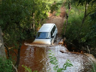

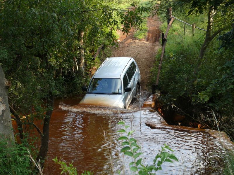

i was horrified when the nose took a dip into the muddy abyss on my first outing but was glad to see not much went into the air intake. just kept the momentum going and got out the other side.

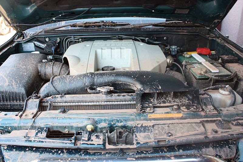

If you look closely you will find that the intake actually pulls air in from the higher part of the engine bay on the gen3 (provided the rubber seal is still on the bonnet.
That rubber seal prohibits any water coming in from between the grill and radiator. It is IMHO a very inefficient design as you are getting hot air in to the intake from funny angles as well.
I have removed the piece of rubber there to allow cool air to come in between the grill and radiator and I'm sure I'm getting better performance. I cleaned the intercooler at the same time (was hardly any oil in it at all) and my economy bettered by about 1l/100km since doing those 2 things.
