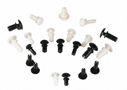

1. Rivet/Snap-in fastener/Grommet
I want to fill the holes. Just remember that not all these holes can be reached from the inside so I must use something that snaps in from the outside. Something like but it must be waterproof.

What do you intend putting over the covered holes?
Nothing, that is why I am looking for something strong and should be goodlooking too. Was thinking of using nuts and bolts but I cannot reach into all the places. I see you get steel rivets (alu/ss) with caps to finish the outside.
Just don't try fixing those rubber wheel arches with pop rivets!
Use RivNuts!
Will def do so, thanx

Why not use RivNuts and then put a nice SS capscrew in the RivNut, or even a Plastic one?jbeez wrote:Nothing, that is why I am looking for something strong and should be goodlooking too. Was thinking of using nuts and bolts but I cannot reach into all the places. I see you get steel rivets (alu/ss) with caps to finish the outside.
Have just been reading up on the rivnuts and have come to the same conclusion.

Maybe you can put flushed flat-head galvanised screws in and colour code them with the body colour?4ePajero wrote:Why not use RivNuts and then put a nice SS capscrew in the RivNut, or even a Plastic one?jbeez wrote:Nothing, that is why I am looking for something strong and should be goodlooking too. Was thinking of using nuts and bolts but I cannot reach into all the places. I see you get steel rivets (alu/ss) with caps to finish the outside.
