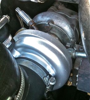

2.5 Tdi Turbo reconditioned & 3.5 V6 throttle body cleaned

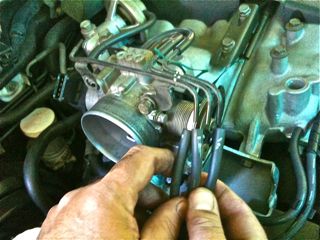

Remember to clearly mark vacuum pipes in order

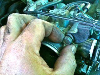

Normally 5x bolts holding the housing in place (4x in front & 1x on side bracket)

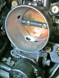

What the throttle body should look like, after thorough clean-out (including rear inlet housing) & no play on butterfly shaft
