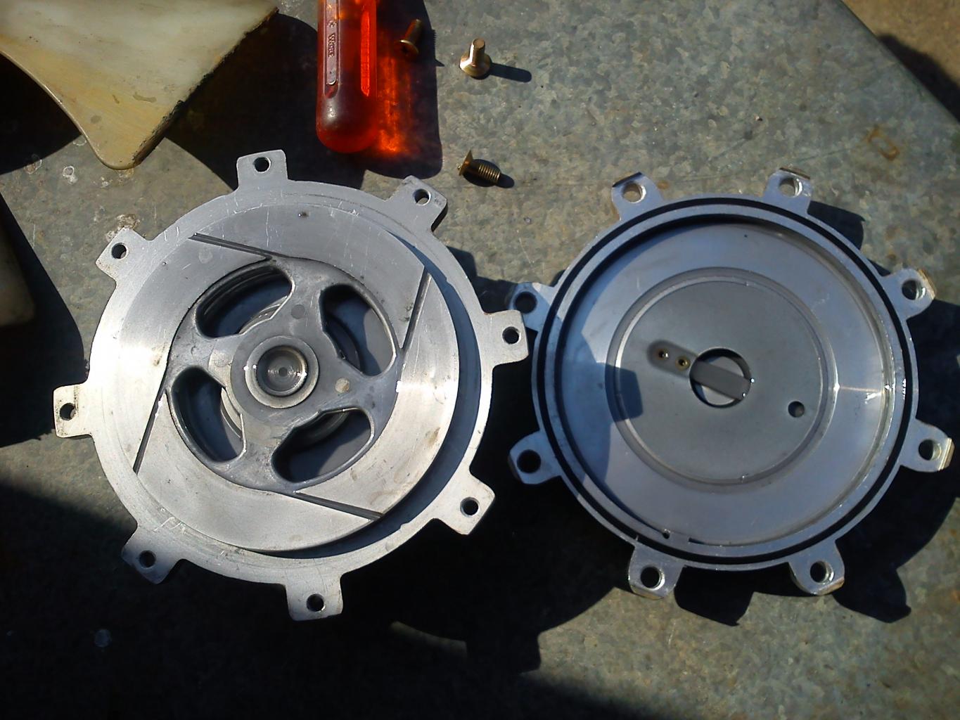

Hi
Could not access the link from work regarding the viscous inside so I opened mine. I assume the plate in the middle of the hole gets pushed inwards, releasing fluid that locks the outer fan circle into motion. Mine was full of the sticky goo fluid and turned with difficulty. Suppose spinning motion will force fluid back to cavity behind plate in middle via channels when plate is closed. Just seems to me that there is always some fluid in my clutch whic is why it always turns/engaged. Might be shaft going into clutch - is this running in a bearing, can bearing be replaced?
