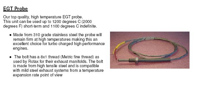

Get a probe from MGL Avionics.
They are not expensive and has a good rep.
I paid R250-00 for mine (but that was 7 yrs ago!)
