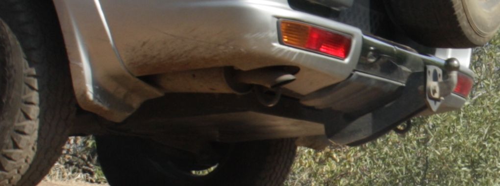

Hi Cloyd,
Having a bash plate for the external tank is not that bad idea.
Also it cant be that heavy can it? i mean i got a 20.5kg 5mm steel Stofpad4x4 bash plate on. From what it seems to protect the diesel tank one need at least half the size (haven't measured it yet) as the bash plate. and not necessary to make it from 5mm steel plate. i am planning on getting a 2mm steel plate made that will wrap around the tank at the bottom and fasten to the existing bolting points.
I would rather have it on that not, the tank cracked on Saturday after a nasty bump to it on the left rear and made the front right bracket (Bolted to the rear suspension frame) twist and cracked the welding on the tank and i did loose a few liters of diesel.
took it in yesterday to be fixed and hopefully will get it back today and refit it tonight.
