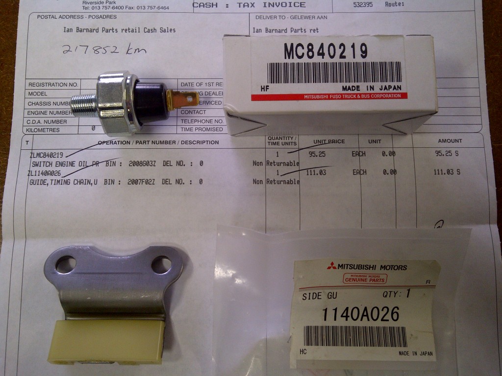

Got my guide and temp switch this week - see the receipt below.
No more sleepless nights then....macjohnw wrote:Got my guide and temp switch this week - see the receipt below.
Does anyone know when in the production(year)the 4m41 were switched to the newer type chain top guide?

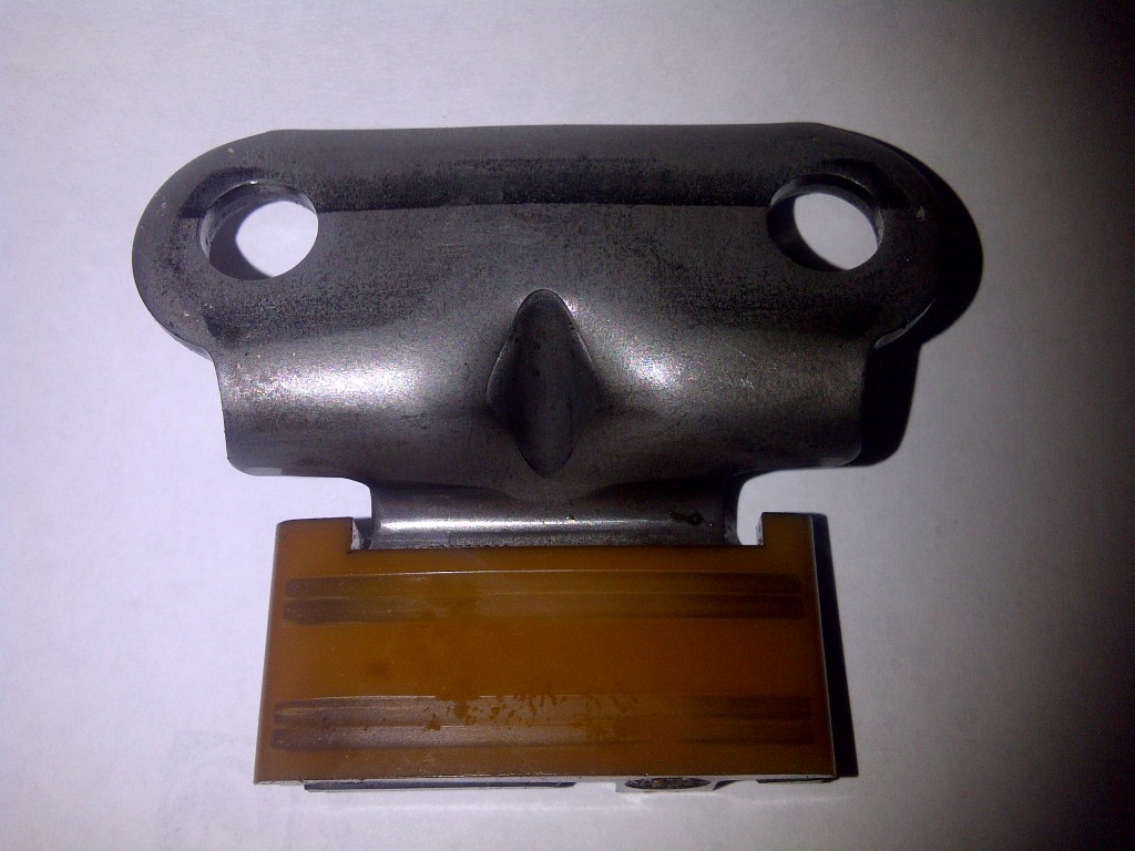

My top timing chain guide after 225,000km - I can barely feel the ridges. Oil pressure switch was also replaced today.
