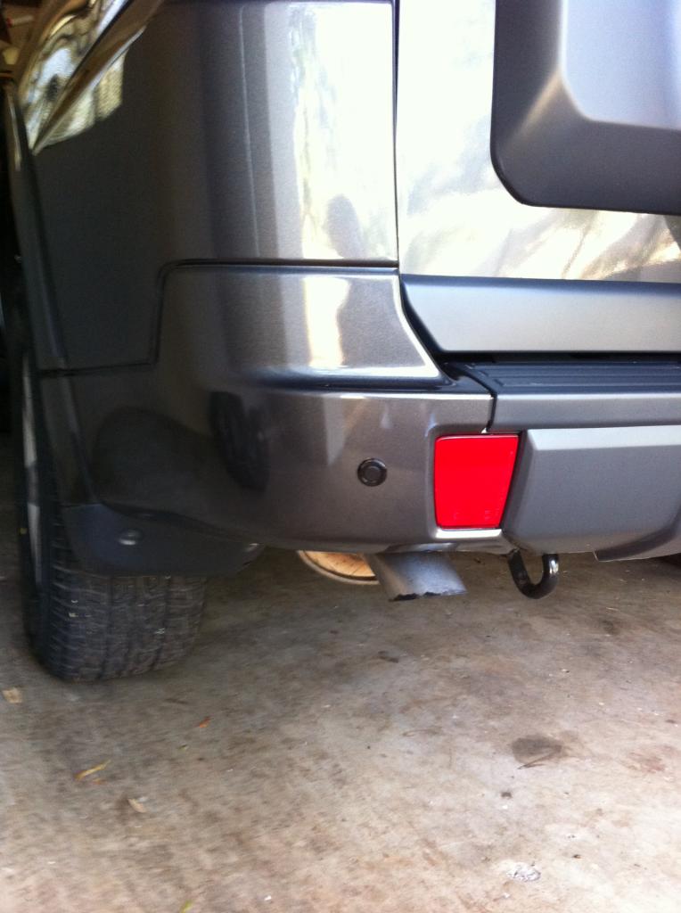

So far (apart from a few minor niggles) I have been very happy with the car, yesterday I had some PDC’s and tyre pressure monitors installed which were integrated into the CASKA system. Unfortunately I have problematic PDC sensor. After doing some tests I found it’s not the sensor that’s faulty but just the exhaust is causing interference and causing it to activate. With the ignition on all seems to be ok, turn the engine on and the sensor starts playing up. Is it possibly the exhaust noise or vibration that could be causing this?
I have attached a pic showing the placement of this sensor in relation to the exhaust. Has anyone experienced this problem before, if so was the situation remedied??
I suspect that the sensor in die bumper is aiming a little too low, i.e. It picks up the road behind. It should be installed to aim horizontally to the back. I had mine spaced up at the bottom to get rid of the same problem. Try to park the car with its backside up in the air, like put the rear wheels on a hump, and test again. that will tell. Is the PDC connnected to the reverse lights and does the problem only show up when rerverse gear is selected? I don't see how the exhaust tail pipe can interfere.

I had a look at the sensors on my car (factory fitted). The corner ones sit near the top of the bumper, your's are much lower (downward facing) than mine. I thus support Bigwill's opinion.
My system also has a setting to allow for a towbar. Make sure they only function in reverse gear, otherwise you won't be able to tow anything

Thanks roelf, bigwill for the advice. Fortunately the guys connected the sensors so that they only operate when reverse is engaged. I rotated the suspect sensor so it now faces out parallel to the ground and it seems to have done the trick. every now and then I pick up a false reading (almost always 600mm away which is about the distance to ground from the sensor) but its now intermittent and isnt associated with a particular sensor, I think this weekend I will rotate all of them and see if the situation improves. At least the system now functions!
