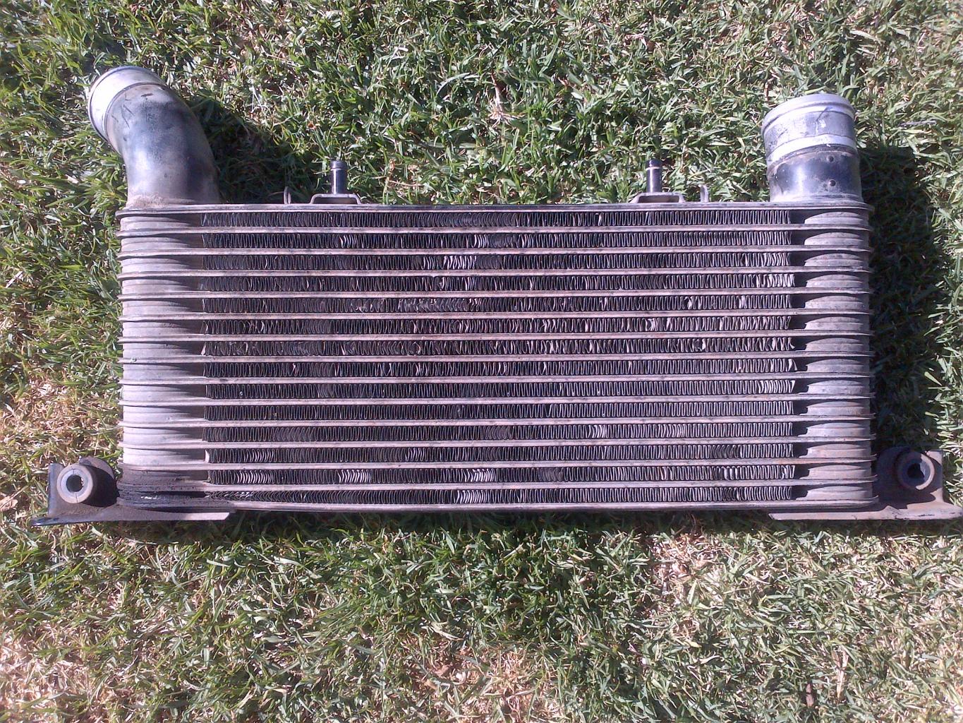

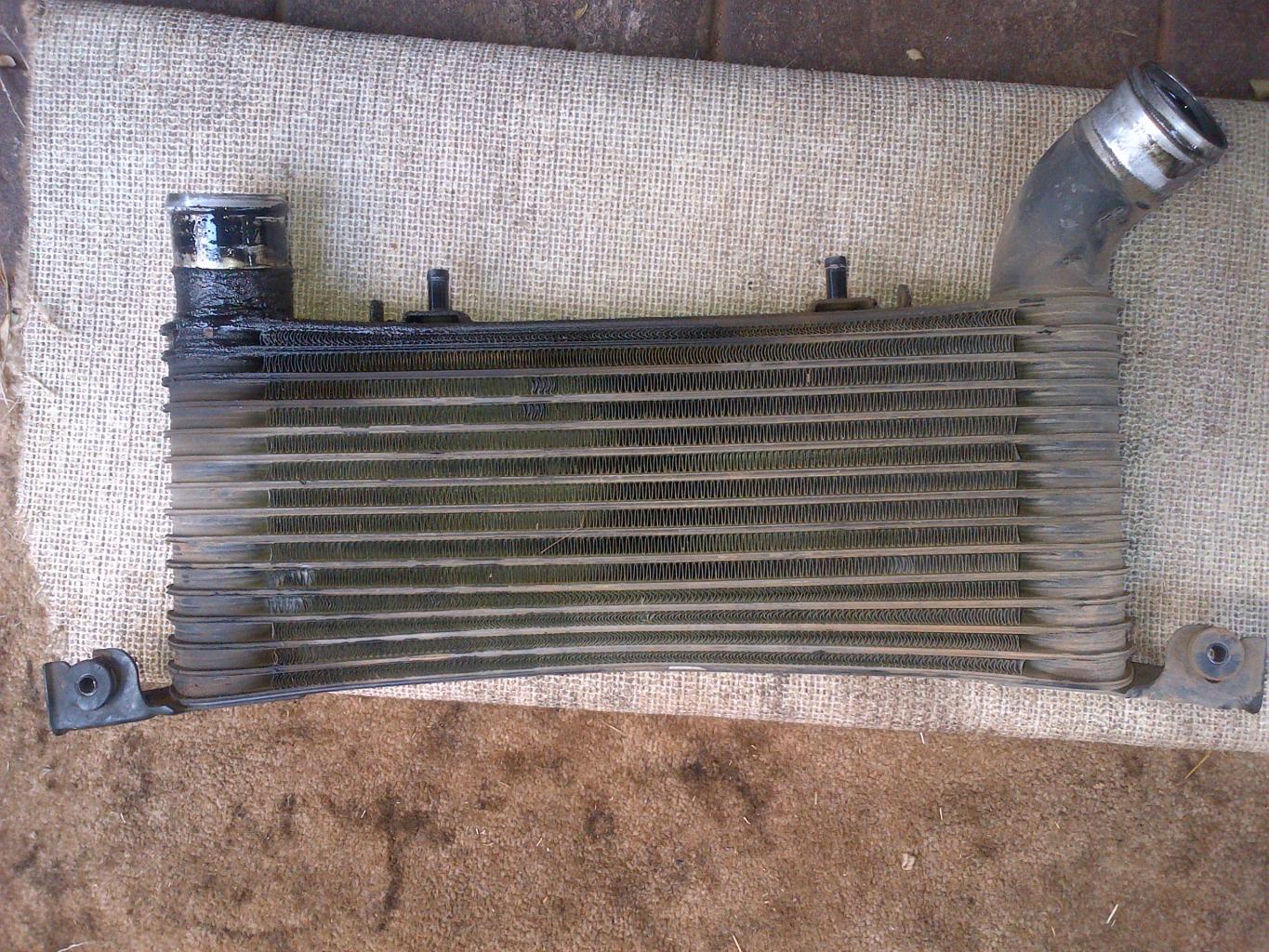

I commented on the position of the intercooler and the damage that can be caused to it
Attached is 2 photographs of two coolers The worst one is one that I paid for and the second is a sample that I got from someone
On the one you can clearly see the damage caused by dropping it on a rock but the second one is "to my mind" damaged possibly caused by the safety plate on the bottom touching the cooler causing vibrations and as a result cracking it
When we hit a rock on the standard safety plate it gets damaged by bending it upwards The space between the cooler and the plate is small causing the plate to touch the cooler
I suggest that you owners out there Check that spacing and if it is bent use a big hammer and a lot of gentle persuasion to rectify this little problem As I said I paid about R6.4K to fix mine The next big expense will be a THICK and strong cover plate
