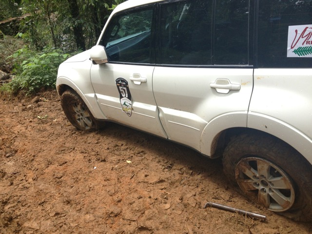

On last OTR event nothing helped me in steep descents and without control I hit a rock and two tyre got burst. But yes I was on wrong tyres on sticky mud terrain..
so basic thing is traction whether its uphill or downhill.no aid is gonna work without grip.
Even the ABS was not working there..on one straight slope the car came down so fast with wheels completely locked by brakes but I can't steer..the other slope I dint apply brakes and no engine breaking or EBAC dint help and the tyre got burst:)
Josef,
I saw the pics you posted after the event. A touch over the top for a standard Pajero on highway boots
Electronic driving aids can only do so much and then it is over to "hang on - here we come!"
