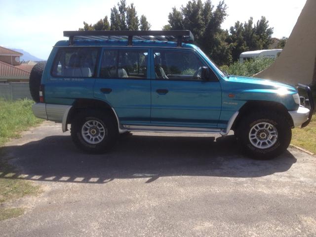

Hi all...i am a newbie to the site and on my 2nd Pajero!
I just purchased a 1998 LWB 3.5 v6 which has almost 172000km on the clock. It did pass an AA multi-point check and has had most of it services upto 160000km.
My question is, FIRSTLY: do i need to have a major or minor service done as the previous owner cannot remember as he harly used the vehicle, SECONDLY: are there any parts etc that need replacing/upgrading or at least a check over to avoid future issues and THIRDLY: can anyone please recommend a decent mechanic in the East London area that won't rip me off and knows his stuff and also won't create any other issues due to poor workmanship?
I really would appreciate any advice/help as i am not so lekker when it comes to engines...
Thank you all

H Garthinza Nice looking vehicle, sure you will have lots of fun!
