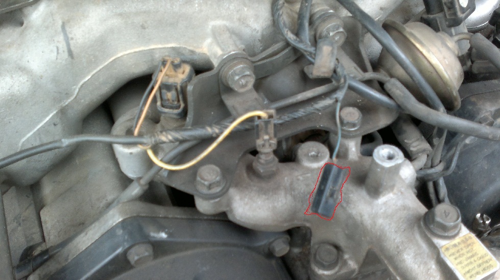

Hi guys - me again,
Now that I have the car back I could take better pics.
See the extra wire in pic below.
I have the car booked in at the Dealers on Monday but would like to know what you guys think
Pierre
Pierre

Hi, the old engine is still on the workshop floor and we took notes of everything. There is a difference between the 2 engines of the number of sensor but that seems to be OK. I'll just drill and tap the sensor for the old engine into the donor one. Should be ok.

Thanks a span you guys. It turned out that this issue and my other problem was related ("Kick down" post). My overdrive did not work and it seems like this sensor controls that.
So I earthed the extra wire and the O/D kicked in!!
I'll get the sensor drilled and tapped in tomorrow.
Thanks again
Pierre
