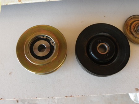

Tried to find an aftermarket pulley, but no success. I managed to get one that was 75 mm in diameter and made a few modifications to test as I did not want to purchase the original, only to find this was not the problem. Atleast on this one I can replace the bearing if it goes again.
Assembled and noise is gone :D :)
new pulley
new pulley
there was enough adjustment on the tensoiner. will the difference in size be a probelm? If not then I will leave this one in. cost of new pulley? 34 bucks for bearing :lol: :lol:

as long as the belt adjustment is fine the pulley size won't affect the engine. In fact the pulley will last longer as the larger radius makes it turn at lower rpm.

Marius, if I am not mistaken the replacement pulley that redvers fitted is a little smaller than the original, so it will spin a tiny bit faster.

ah.. I only glanced at the picture and thought the black one was the new one.

This is an after market part for an aircon supplier and one of my customers make these. I just had to make 2 spacers to get the correct diameter and distance for the belt. the bearing id is 17mm instead of 12mm on the original. The dia is smaller, but there is enough travel for adjustment.

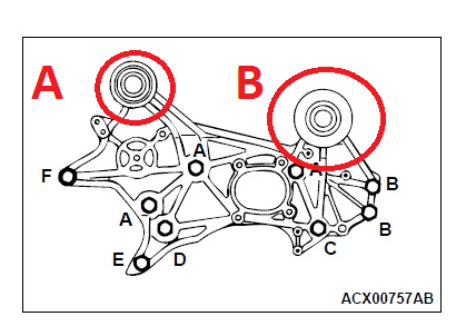

I am in the same boat as you for that idler pulley, was it the the plastic grooved one (A) or the big smooth steel one(B)?
I just cant get my self to pay R 590.00 for something that costs a fraction of that to make...
PS. Sorry, your pic only loaded later, I see you replaced the steel idler pulley, I need the plastic one...

Yes mine was the steel pulley, but I see from the other thread that you have managed to source both.
