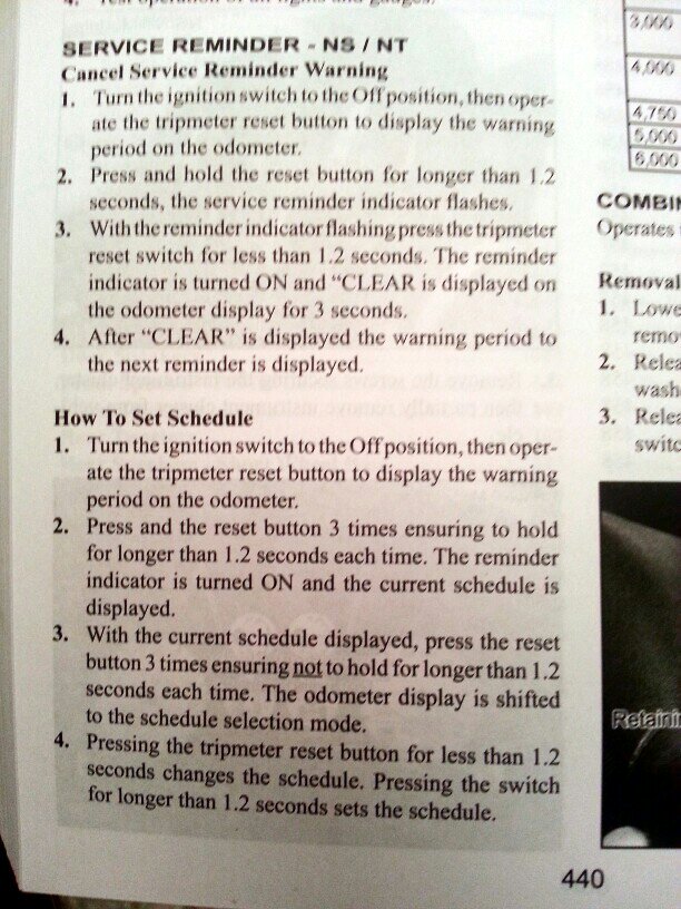

I know I have read something about this somewhere, but a search came up empty, so please help: How do I reset the service indicator?
My 3.8V6 is due for its first dervice after the maint plan. You may recall that I did an "inbetween" oil change and the engine is now running on DELO 400.
If I take the car to the dealer for the 105k service, then I'm not too convinced that they will put DELO in on my request. If I use my indi (where I will definitely get DELO 400), then I'm not too sure how to reset the service indicator.

Mine was also out and i was told that it can only be reset via the computer?not sure how true this is.
Thanks John,
From what I can remember is that any distance or time can be set (when it gets gone
), so ideally would one like to set it for 20 years and 2 million km and forget about it. When these great 3.8V6 motors get there, it will hopefully be the next owner's problem
Masker,
Great stuff. Now to practice the old fingers to make sure I know how long 1.2 sec is
