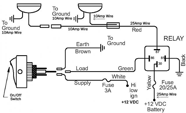

Spot light installation is quite an easy DIY job. Go to any Midas or Auto zone, tell them what you want to do, they will supply you with a relay, switch, wires, lugs and fuses to do the job. Will probably only come to R200-R300 for parts.
See attached diagram for wiring schematic.
Or you can go to an auto electrician (motolek etc..) to do it for you for close to a grand for parts and labour.

remember the gen2 can't use the normal relay feed as it uses negative switching on the headlights.
Give the sparky this diagram to make the job easier for him
Re: Spotlights installation
4ePikanini wrote:remember the gen2 can't use the normal relay feed as it uses negative switching on the headlights.
[ Image ]
Cool, I didn't know the Gen 2's used negative switching (my hilux also had negative switching), my gen 3 has positive switching however. Good to know.
