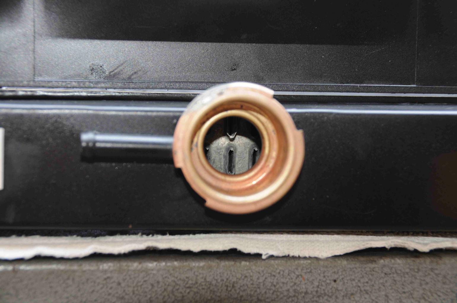

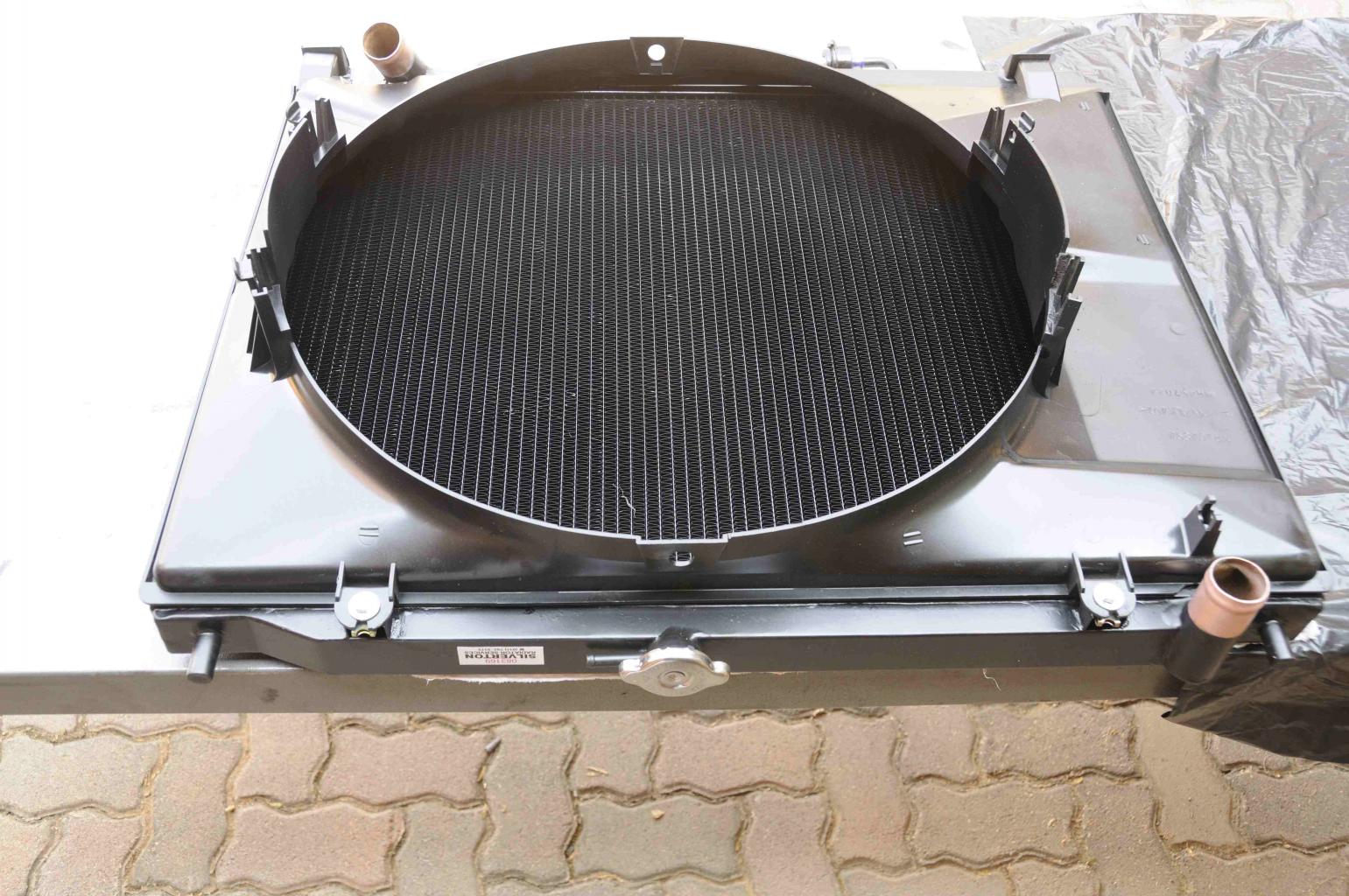

I have to say that I was delighted with the 3-core copper core radiator Silvertons in Strijdom Park fabricated for me at R4443.72 incl VAT (Thanks Morne and Rudi) - about half the price of an OEM aluminium single core with greater cooling capacity, greater coolant capacity and more maintainable in out-of-the-way places (brass tanks can be soldered and don't split like plastic tanks do). Here are some pics: There are a few more high res pics on flickr: Pajero 3.2 Di-D replacement radiator jacashgone
I finished the install yesterday and took the paj to Silvertons this morning for them to do an in situ pressure test (they also did an exhaust gas test) and all is OK so I went for a burn along the highway afterwards.
Hopefully I won't have to be worrying myself about overheating
for a long time now.
