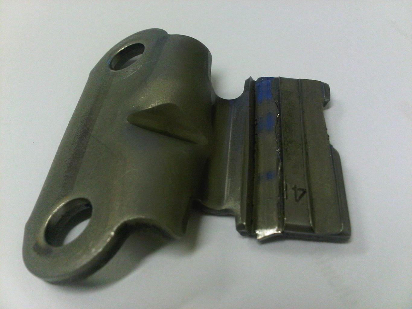

I had the timing chain guide replaced today and even if it is not related to the engine noise I am trying to identify, I am very lucky that I did. Have a look at it and see just how lucky I was !!!

Malcolm wrote:I had the timing chain guide replaced today and even if it is not related to the engine noise I am trying to identify, I am very lucky that I did. Have a look at it and see just how lucky I was !!!
Mmmm I would say it was due for replacement earlier!
What would be of concern is where are all the chunks of the nylon (?) block? You wouldn't want them running around the engine.
Re: Unidentified engine noise
Probably either dissolved due to wear or drained out with the old oil during the routine services.
