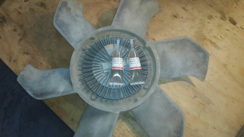

After years of dealing with a jet aircraft landing roar which turned heads and frightened newspaper vendors at the traffic lights, I was forced to address it when a rather expensive sound was rattling at the front of the 3.2 Di - D motor.
The viscous was ALWAYS on, even if it was 17 degrees outside and not driving hard. FLIPPEN noisy.
Guessed the new noise was v- belts, as it calmed down as motor warmed up.

After starting, noticed noise was still there, but now there was a metal to metal sound. Saw the main pulley was running really bad now.
Stripped all out again and found that the front pulley had separated. It's a two part assembly, presumably for vibration damping.
Panic sets in. Call to the dealers reveals one IN STOCK , in PE !! R2200
After a call to Marius 4e Pikanini (?) on the bolt removal trick ( Thanks boet), new pulley fitted, reassembled all.
All quiet now, including only occasional running of the fan which quiet end down in seconds.
