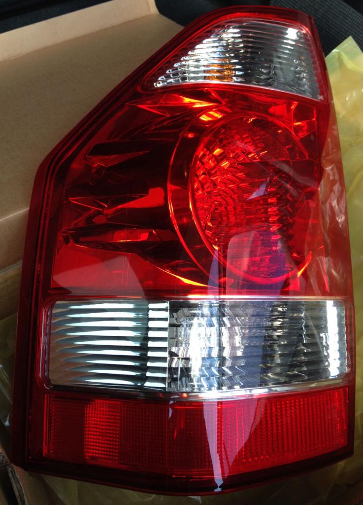

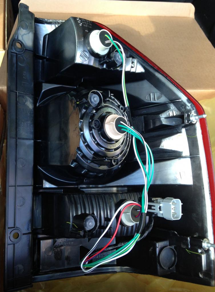

I have just received my new tail lights from SG Auto Parts in Brackenfell and am having them fitted on Wednesday. The plugs are not quite compatible though.
This is what they look like:

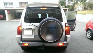

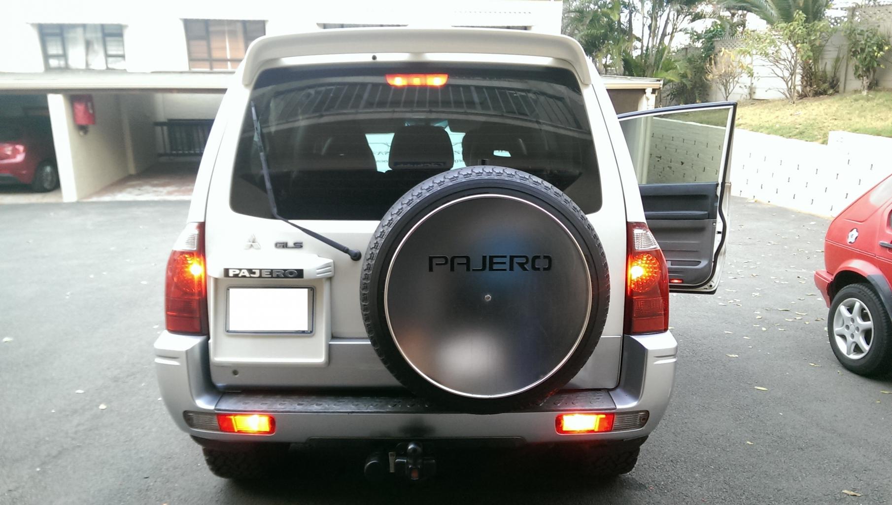

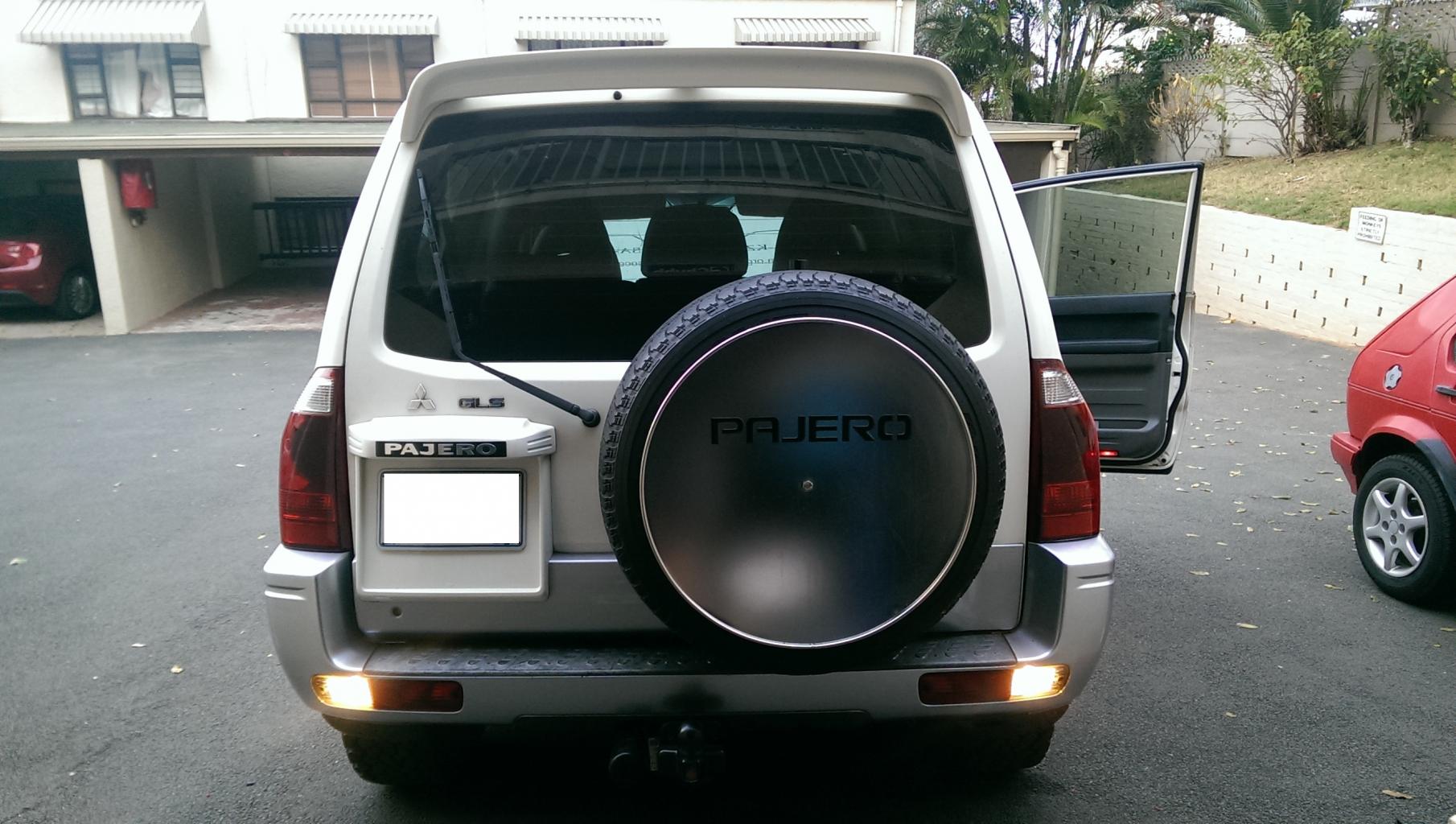

I finally got time this weekend to do this.
I retro fitted the current lights to take a dual filament holder.
I also moved the reverse lights to the bottom and put the indicators up top. All in all took a few hours and well worth the time and effort! So happy with the results. Makes a huge difference to visibility!!
Looks great!naviuk wrote:I finally got time this weekend to do this.
After changing mine, I have had a two people coming up to me saying that it is so much more visible.
