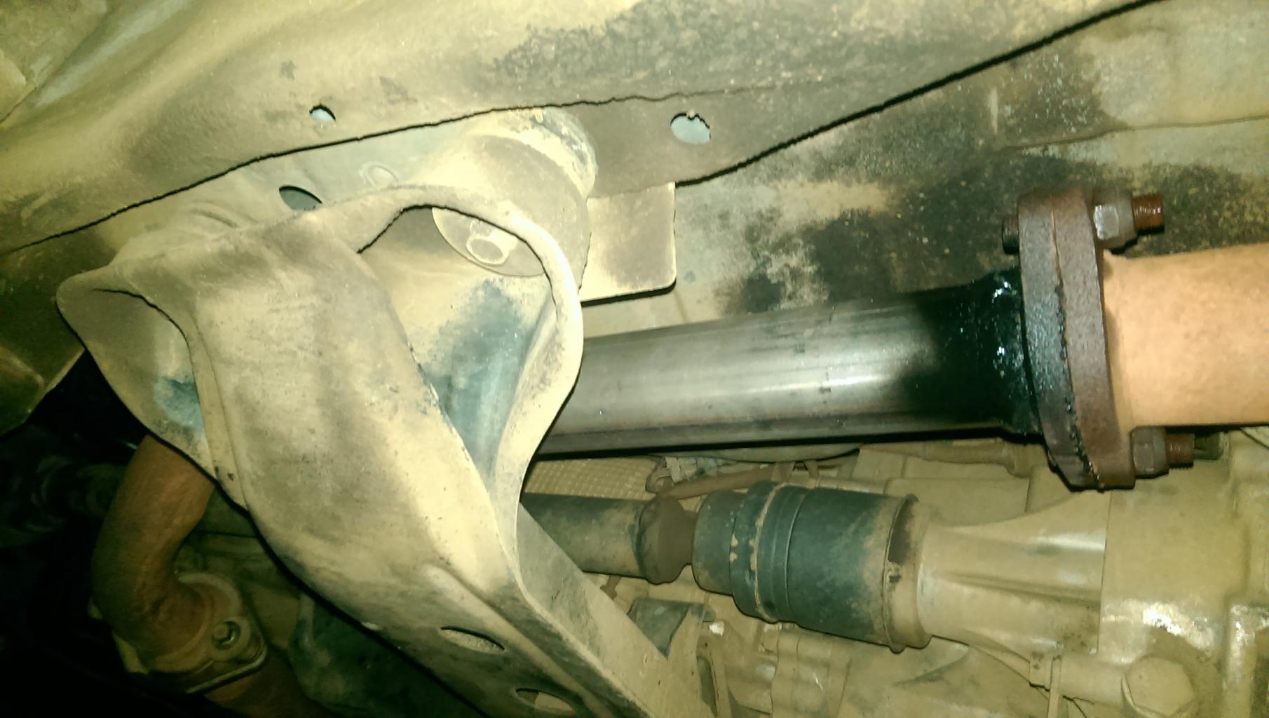

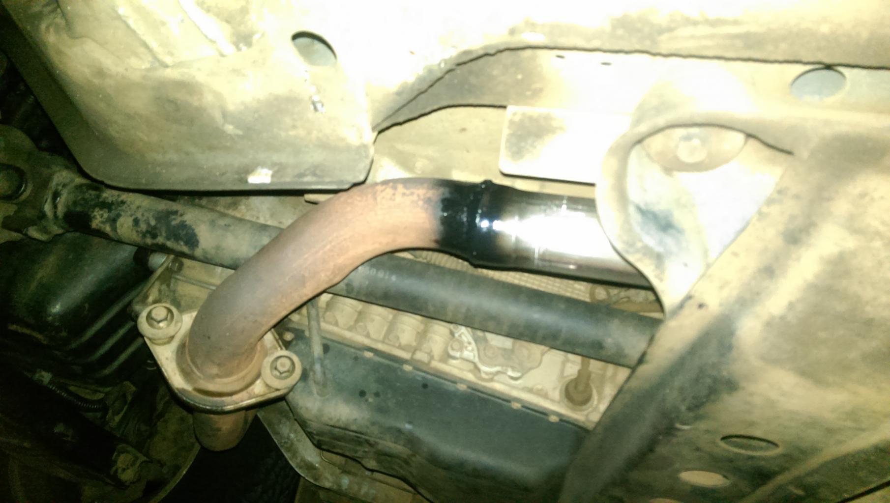

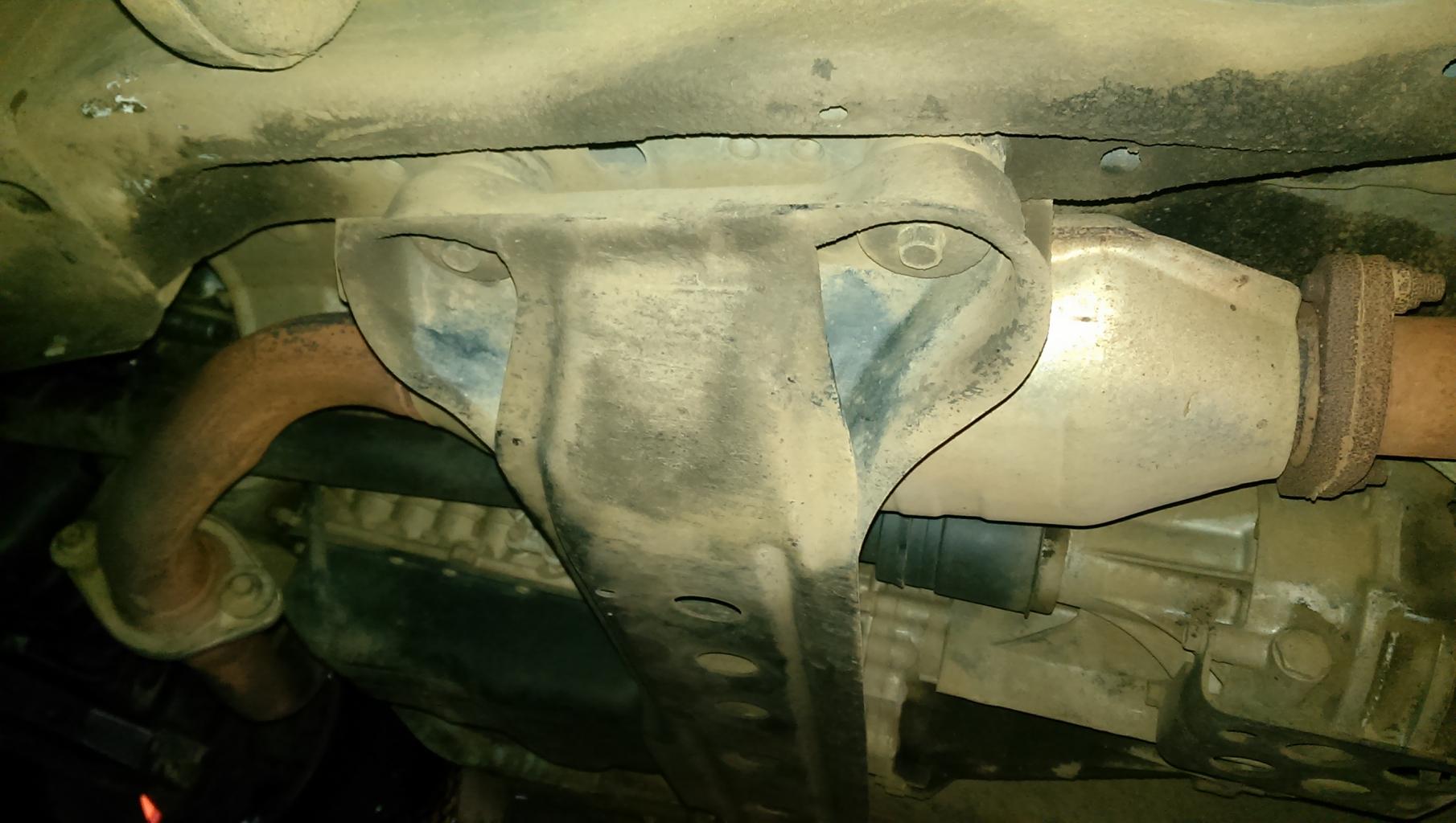

In terms of differences. it's hard to see if the CAT was really blocked or messed up or not, but with 268 000 km on it, I cannot imagine it was very free-flowing. I didn't drive it too far as yet and still far too early to base on consumption but i have noticed the Pajero seems to rev smoother and the engine seems quieter like there is less effort to rev up to that RPM and doing 110 or so feels alot less effort then before. It could all be in my head but will get the Mrs to take it this weekend and see what she says.
Here are some pics of before and after.
