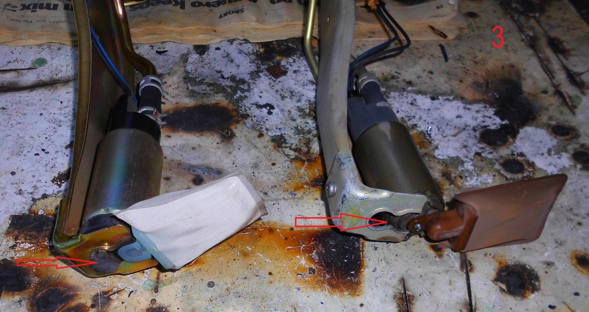

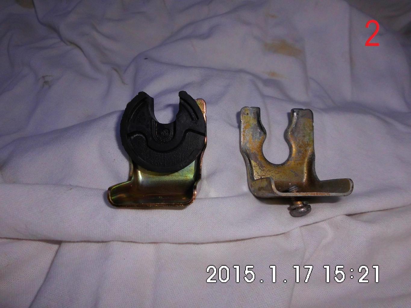

summation of my fuel pump story:
symptoms were reluctant cold starting; reduced power at in high gear; no whirring sound at ignition-on.
my choices where new dealers pump for R7000, new universal pump from Mitspro for R3000, used pump from Part Hunt for R1700, new Bosch universal pump from Diesel Electric for R1200; new japanese universal from Breno Auto Parts for R250 (!?)
decided against universal; got a new pump from Part Hunt R2000; perfect fit.
problem solved: starts instantly; power's back where it's needed.
in the pic 3 you see new & old side by side:
the rubber foot had worn away completely; that was the black silt i discovered in the supply line filter, having passed through the hard/nylon suction filter.
