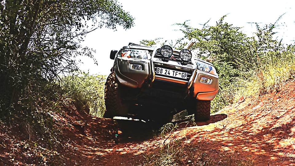

I have included a Pic that I think is pretty cool...
Shot okes
Have a good one !
