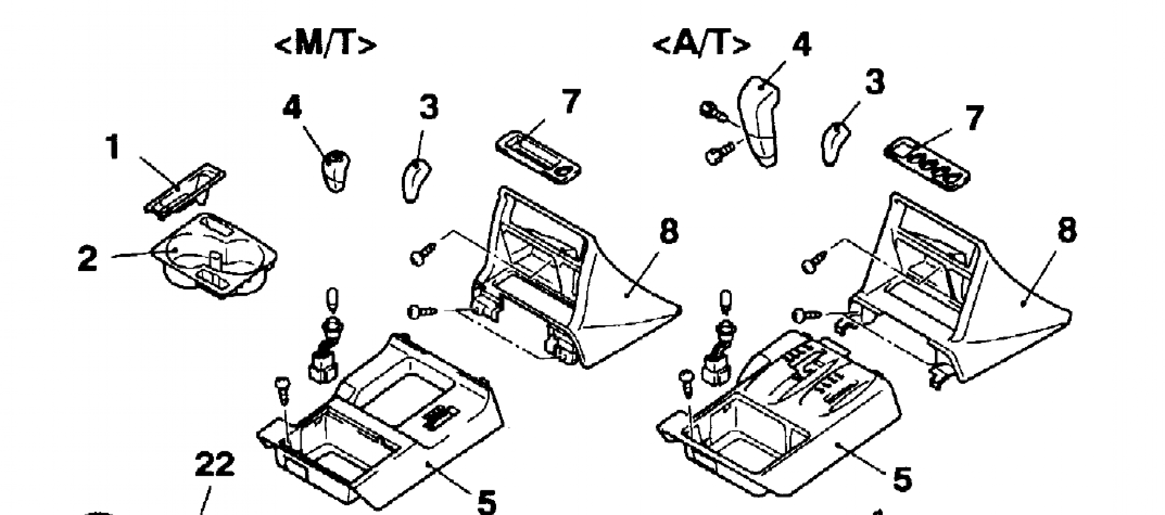

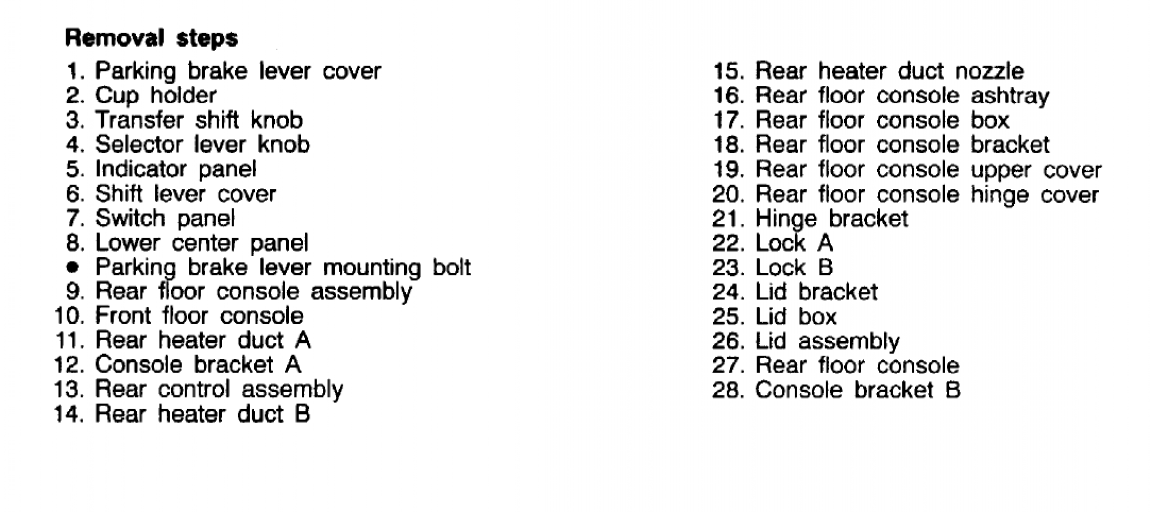

Hi there - have just returned from Namibia after driving over some 5000 kms of gravel roads, mostly good but some exceptionally corrugated. Really really impressed with the Paj's ability in such conditions, the only casualty being the cigarette lighter which worked its way loose, shorted and blew a fuse.
I have 2006 3.2DiD Auto......how do I get into the dash to re secure the lighter. Can anyone help ! :(
Re: Removal of dash to secure loose cigarrete lighter
See Pictures for removal instructions, start at point 1 and work up numerically until you get to the area behind the cigarette lighter. Reverse the process for re-assembly.
