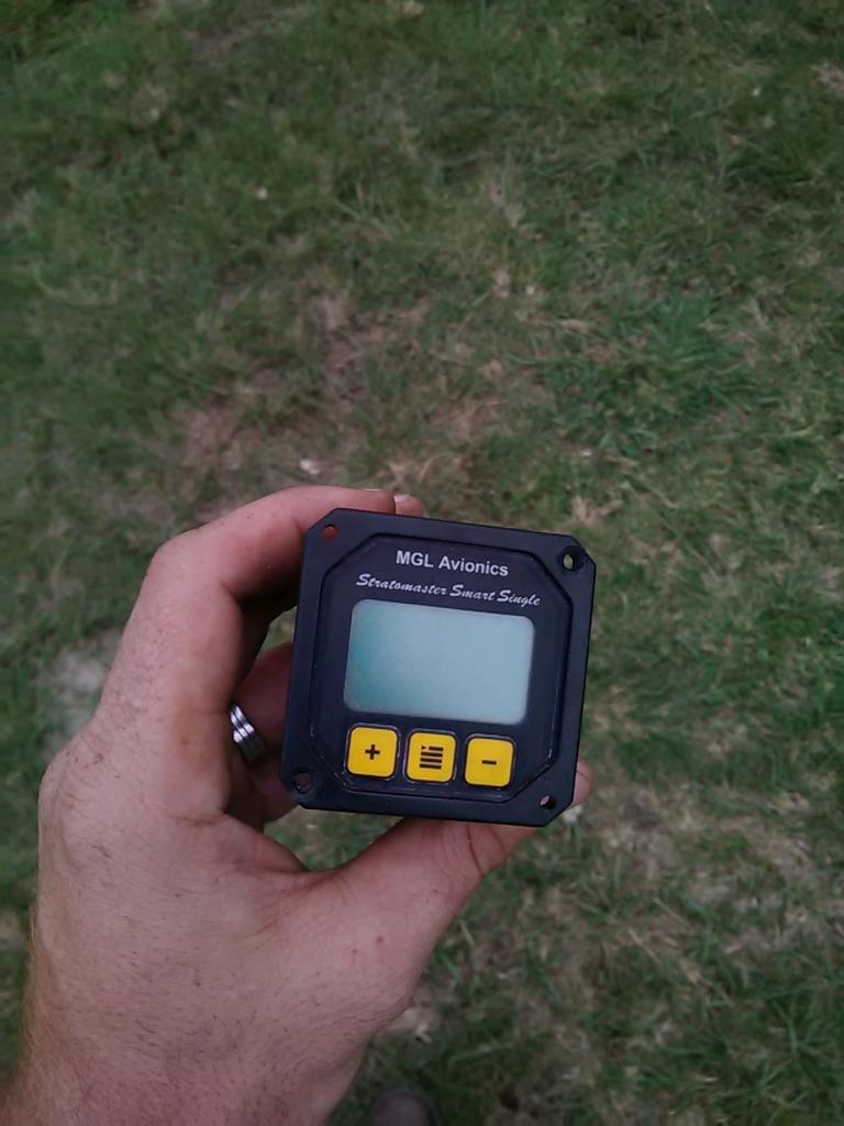

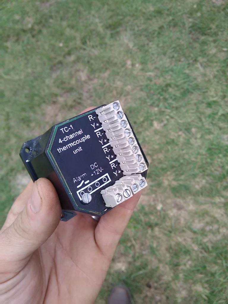

Dad forgot to mention that the avionics can take j-couplings or k-couplings.
It can actually take 4 and display all 4 values at the same time. It can also have programmable alarms for high and low values.
ie.
EGT
Oil temp
ATF temp
Coolant temp
Or you can check your IAT's or CHT.
It is a quality product compared to other gauges and has a very nice interface. Money well spent IMHO.
