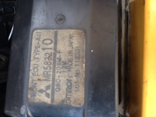

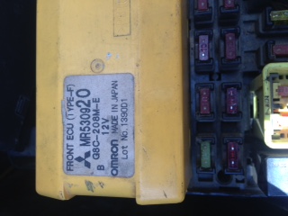

Can someone tell me if there is any difference on the front ECU used for a diesel and the one for a Petrol Paj. The back ground of it is i went out to a scrap yard this afternoon looking for a front fuse box to replace the one on my car ( i broke the brackets for the one on my car- long story :oops: ).
The scrap yard guy came up with a fuse box. Everything inside looks exactly the same except for the ECU. the on this fuse box is a Type-F, while the one on my car currently is a Type-Ac. I asked the scrap yard guy whether the box was from a diesel or petrol car but he is not sure though his inclination was it might be from a petrol.
See attached pics.
the one on box from Scrap yard
From my Paj
From my Paj

I would think that they would differ. Why dont you just swap the ecu around between the two boxes?
