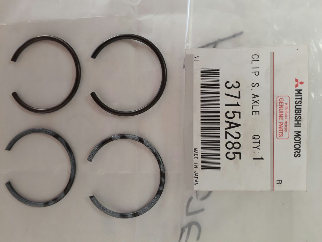

Now, there seem to be a lot of discussion and some confusion about an upgraded circlip that was thicker to replace the thinner original one. Nobody could tell for sure if this was true or if if the new thicker circlip would even fit onto the shaft. Off I went to the dealer and ordered 1 x set of ciclips, 1 x set of oil seals and a new diff sump nut as it was stripped. All parts had to be ordered from Japan as Mitsu SA did not carry any such stock.
After a month I got the parts and picked it up a few days ago. I noticed that there were in fact 4 x circlips, not two. It turned out that it was two sets of different thickness (and shape) circlips. Took the car to my local Gearmax and asked them to install it - felt confident when the labor/mechanic told me he is aware of the different circlips as he had seen it before on similar Pajeros. The shape of the shaft's groove will determine which circlip to use apparently.
They installed the thicker circlip and they work well so far.
