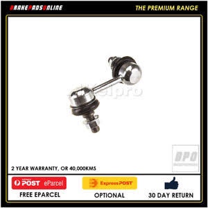

Check your sway bar links. They look like this:

Agree with Kurt - also your bushes on your control arms

I’ve check both the sway bar links and the control arm bushes. Just from scanning it as much as one can laying in the sand they still look good. No movement and not perished. Don’t know if there is another gremlin inside somewhere...
