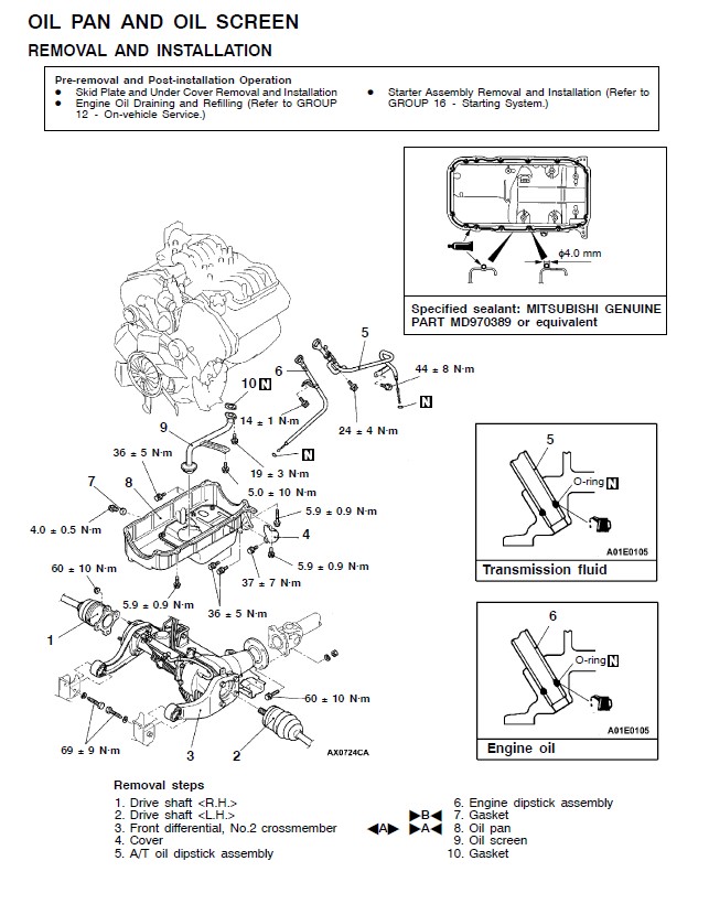

Hi Tony
I recently had to remove my starter motor and to do so I had to remove both ATF and Oil dipstick tubes. I am assuming that your ATF dipstick guide is maybe not correctly seated and hence catching where it enters the gearbox.
Have a look at the attached drawings from the service manual and it may help you solve the problem. The guide tubes are easily removed but not that easy to get back in place unless you can see what you are doing. Make sure the O-rings are in place at the end of the dip stick guide tubes.
I hope this helps
Paul

Re: 2008 Pajero ATF dipstick
Thinks Paul. The though of their being a 'lip' crossed my mind but it doesn't look like the pipe has been removed before - but it's an old Paj with over 260KKm on it.
I purchased the vehicle second hand so who knows what may have happened.
I did suspect the Pajero had a front end bash at some time, most probably more towards the passenger side, because I noted the horns had been bent on their brackets - so maybe that could have jarred the pipe.
Anyway I'll have a look and see but I suppose the engine oil would have to be drained first :-( so perhaps the next time I do an oil change.
Thanks for your suggestion, Paul. I'll certainly look into it because its a royal pain to get the dipstick back in.
Hi Tony
No need to drain oils to check the dipsticks as I removed them while doin my starter motor and did not drain any oils. Just be careful when fiddling near the starter motor as the positive from the battery can easily be shorted by accident, so best to disconnect the battery before you start fiddling down there. I really hope that you come right.
