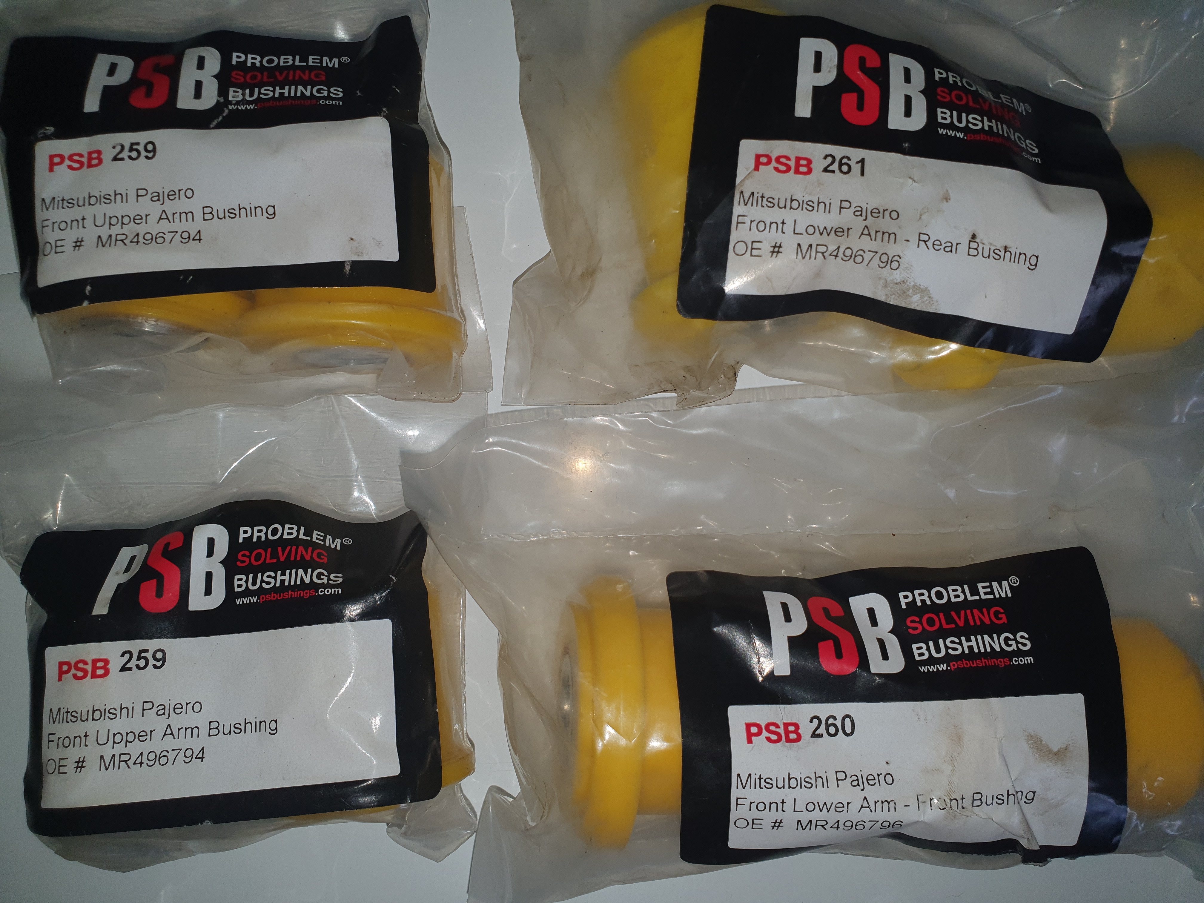

I bought the bushes from Amstrong Distributors in Kokstad, KZN.
Their part numbers PSB 259, 260, 261.
R2265 incl Vat for the 8 bushes on the front suspension for upper and lower control arms (wish-bones)

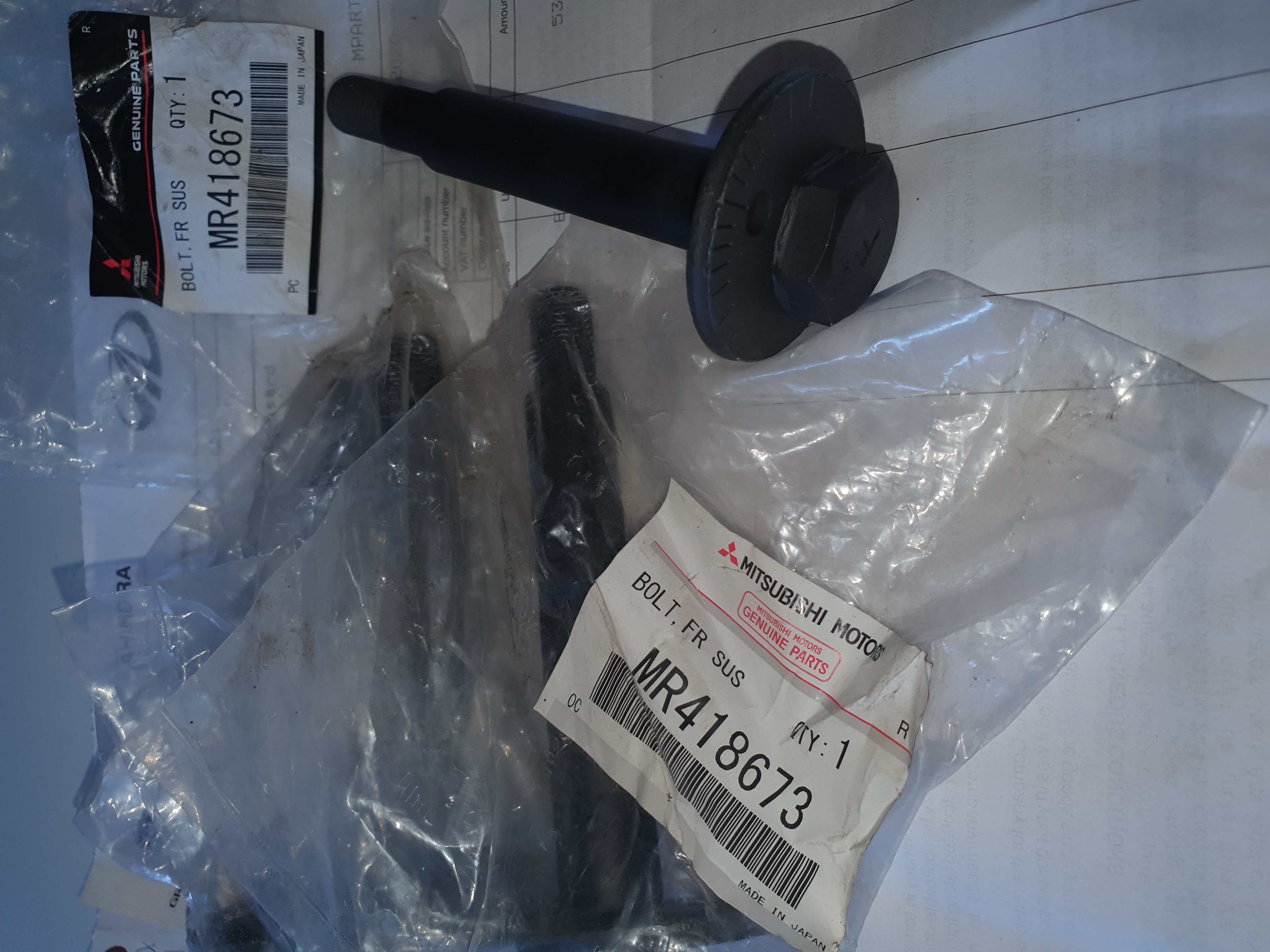

I made a 'press' to try and push out the bolt after applying generous amounts of Q20, using a 8" G-clamp and a 50mm steel cup on the camber bolt head side. I kept the nut on, so not to damage the threads whilst pressing or knocking.
However, it seems that no bolt rescue will be possible. (Cutting off with a grinder not possible due to space constraints) .
Eventually we had to apply flame heat to the bolt head and nut side and get the persuasion tool's help in, (which damaged the threads). you have to get the nut loose and off first. Then you can fit the nut back on to hammer on after applying heat.
- I bought new bolts from Mitsubishi at about R176 per bolt)

Update. I decided to buy the 4 camber adjustment bolts rather than having it machined from a M16 x 110 long bolt. (22 bolt head and 17 nut.)
The part number is (L)MR418673.
Now for cutting the old ones out, removing the control arms and pressing the old bushes out and pressing the new ones in...

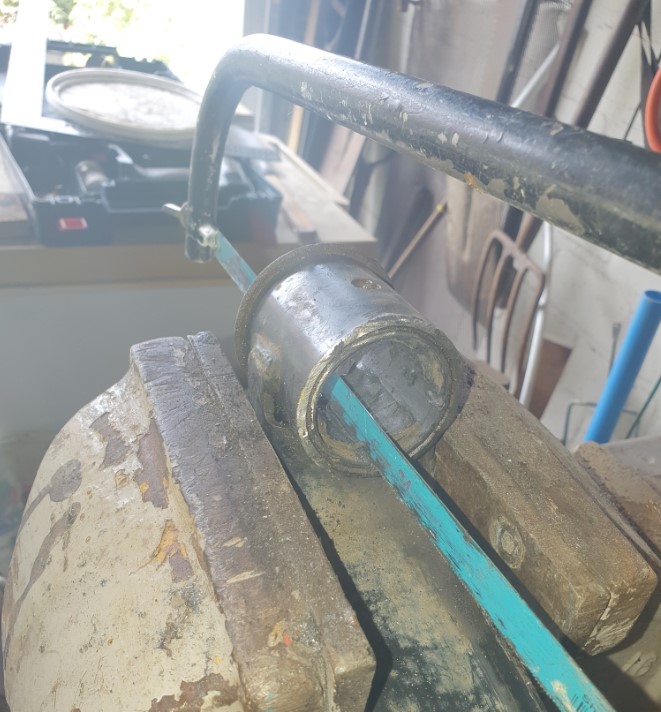

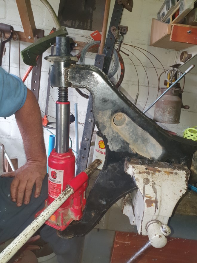

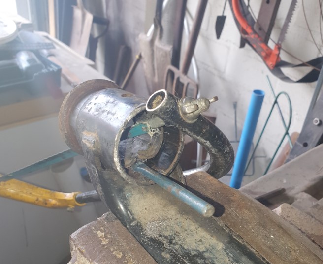

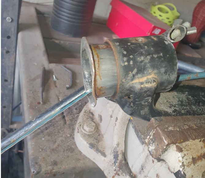

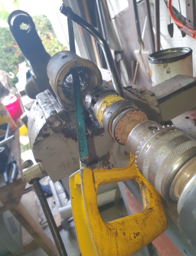

You need the following tools:
1. 33mm hole saw and arbor to drill out the center steel bush.
2. 2 Ton Bottle jack and 30-40mm metal bush. (after using the holesaw to drill the metal bush out as far as possible). You cannot press out the whole bush at once! you will damage the control arm.
3. Hacksaw to cut the intermediate steel ring + also cut the to outer steel bush cover / collar.
4. Small 8mm chisel and larger 15mm chisel to knock the original steel bush and collapse the steel outer collar part
5. Hammers and a solid Bench Vice as this process does include some flogging.
6. Oxy-acetylene gas welding set to apply heat as some of the metal outer part are tuff to get out.

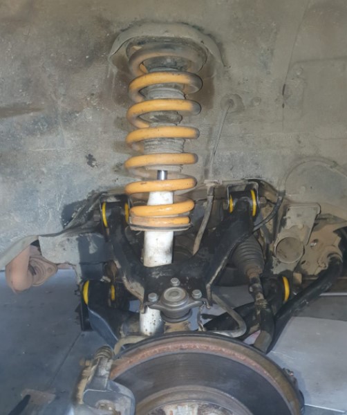

I am toying with the idea to replace my front upper and lower arm bushes with poly. Got a quote on the 259, 260 and 261.
What difference did the poly bushes make to the suspension? Some say it gives a firmer/harder ride.
Did you do the rear as well?
I only did the front wheels. The PU bushed I bought had aluminium centre bushings in and were manufactured well. Some others the centre hole are not so centre.
Like all PU bushes, they creak a bit at times, even with ample Graphite Ghries.
