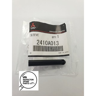

Have a look at the "plastic pin" inside the main gear selector. Trawl the web and you will find it, it was about R 180 rand and I replaced mine out of old age. Approx. 35 mm long x 5/6 mm diameter, hollow with a rounded tip.
Remove the main gear lever, two Posi/Phillip screws. be careful they are small and go missing very easily. Carefully remove the gear knob and you will find it under there, lots of silicon grease and away you go.
