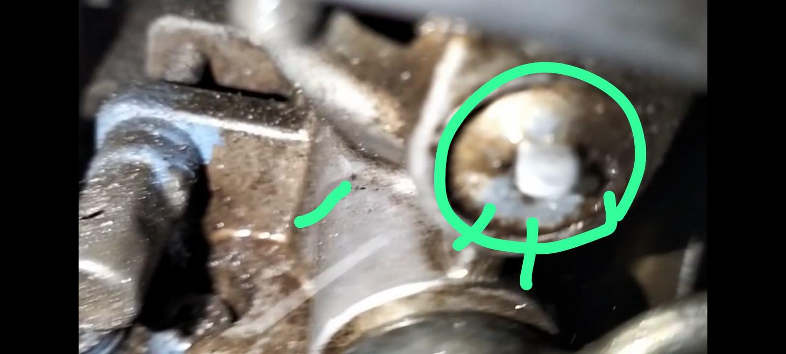

I have a 4M40 Pajero with the Zexel VE mechanical pump. I'm trying to locate a replacement overflow valve (fuel return pressure valve) — the one under the banjo fitting on the rear of the pump.
My current valve is leaking from the center/top, and diesel is squirting out while running. I believe the internal seal or O-ring has failed.

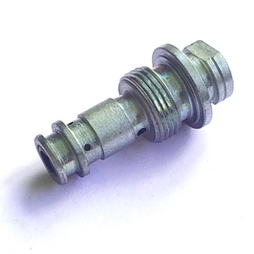

✅ Does anyone know where I can find a Zexel 146110-3220 or equivalent Bosch 2 467 010 005 in South Africa?
I spent my entire day phoning around, but could not track the part down, and 80% of the people I spoke to just wanted to overhaul the entire pump. As I understand, it's a fairly basic procedure to remove this valve and there is no need to re-calibrate the entire pump after replacing it. Attached is an image of what I think it looks like (I will remove mine tomorrow)
as well as screenshot of where diesel is being squirted from. I circled the area where the excess diesel is ejected from with green:
The car starts hard in the morning. I replaced the glow-plugs last week, as well as the starter during the previous week. The starter was only a year old, and got damaged due to diesel that got into it. Go figure.
