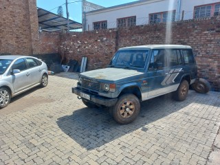

I just got my hands on a needle in a haystack, these gen1 pajeros are seamingly impossible to find in south africa, so when i had the chance to trade my gen1 colt for this one i could not pass it up.
The poor old girl has seen 550k km on african soil, so she is in need of alot of love and patience
It came with the original 2.6 carb engine in pieces(block is beyond repair) i only have a few months to get her up and going before the annual Olifants 4x4 weekend :D

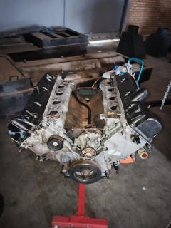

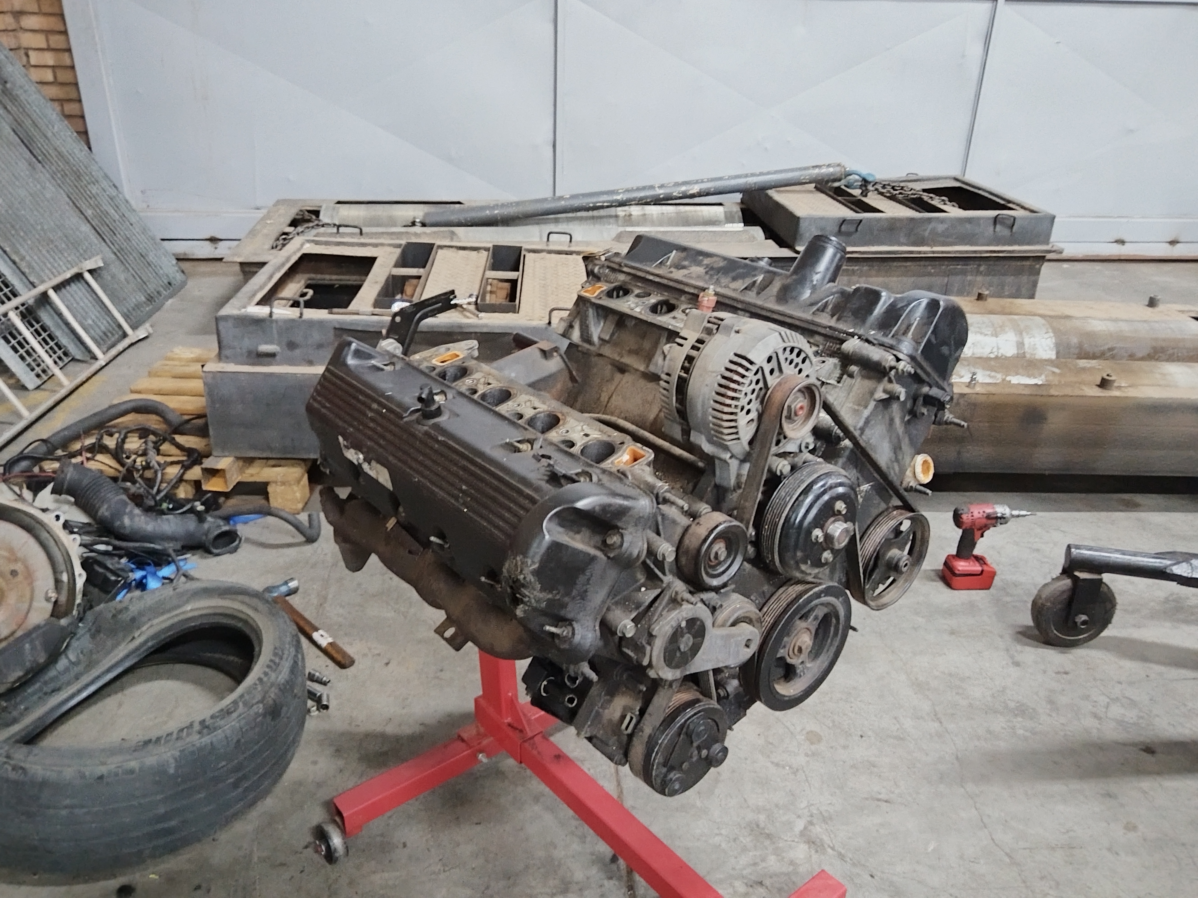

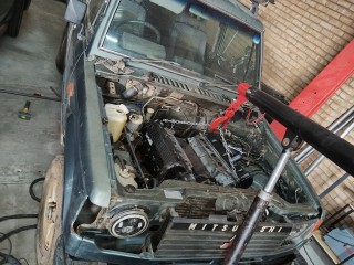

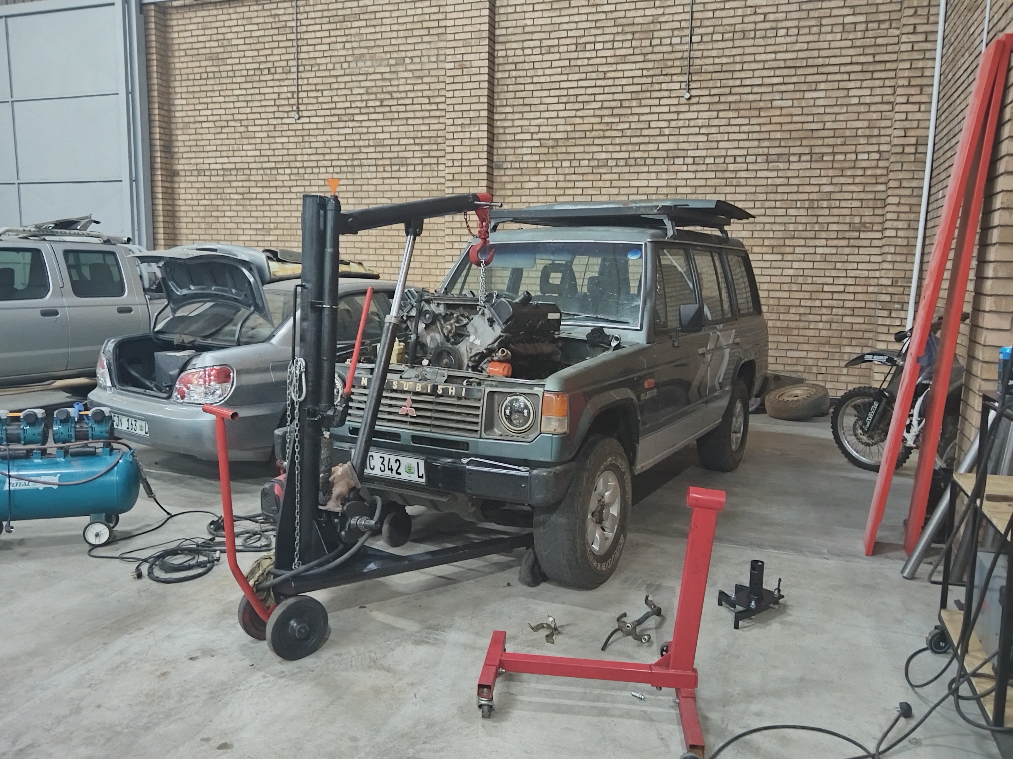

Ok so i have made some progress with the build, i ended up going with a 4.6l v8 from a 2000 ish mustang because it was too cheap to pass up. First thing i did was strip the engine to the long block and presure washed the living hell out of it ( its a ford motor so obviously its been leaking oil forever). Then i tried to testfit it, well initially it wouldnt fit, so i striped out the aircon piping and removed the headers, i got it squeezed in but i was having some clearance issues so ive decided to do a 80mm body lift to open the engine bay up. I have since, pulled the pajero gearbox and pressure washed the living hell out of it too. I have taken the whole setup to an engineering shop to build the adaptor plate setup.

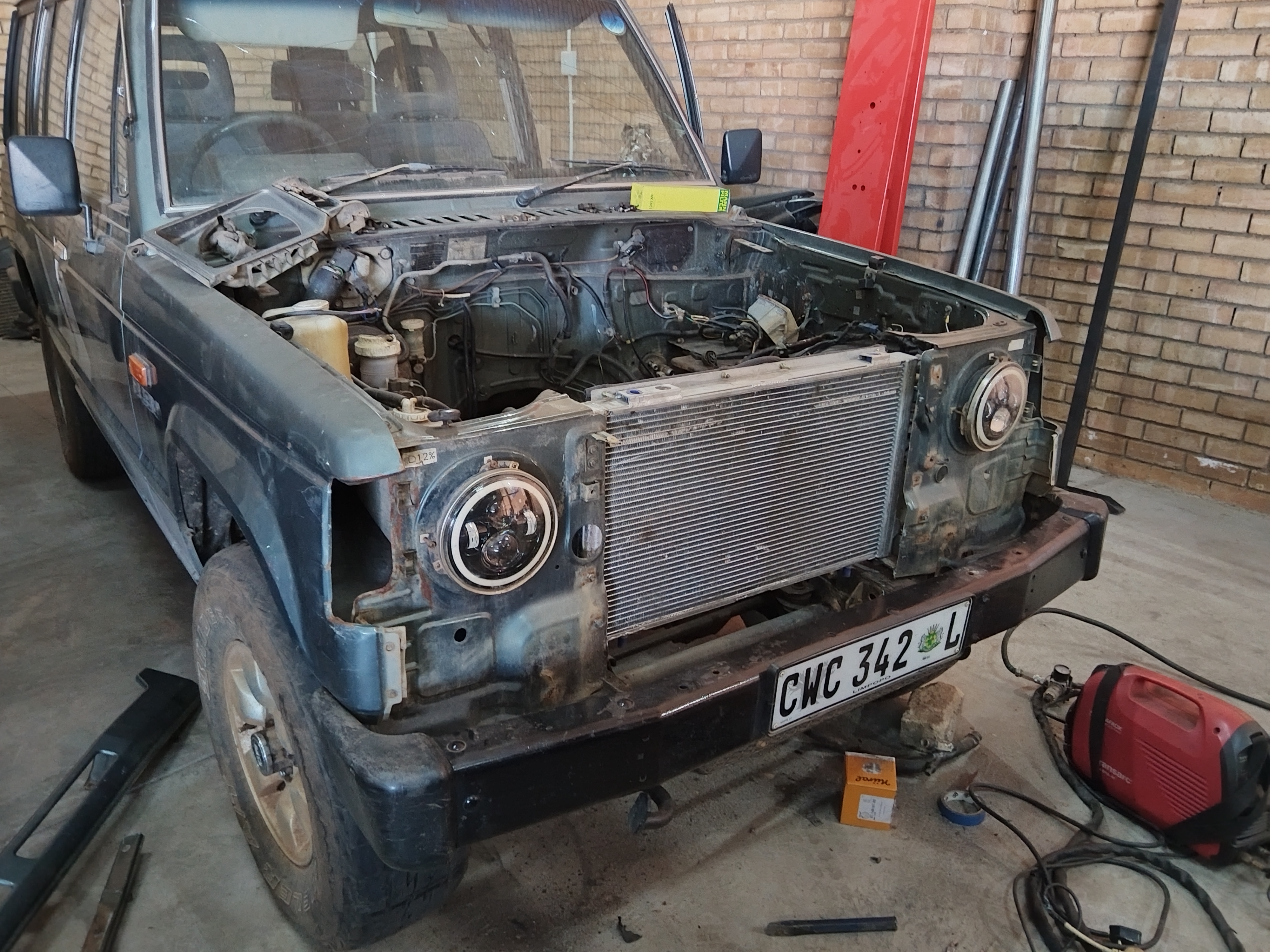

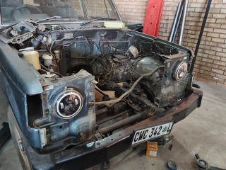

Since im waiting for the adaptor plate, i started to strip out the front end.

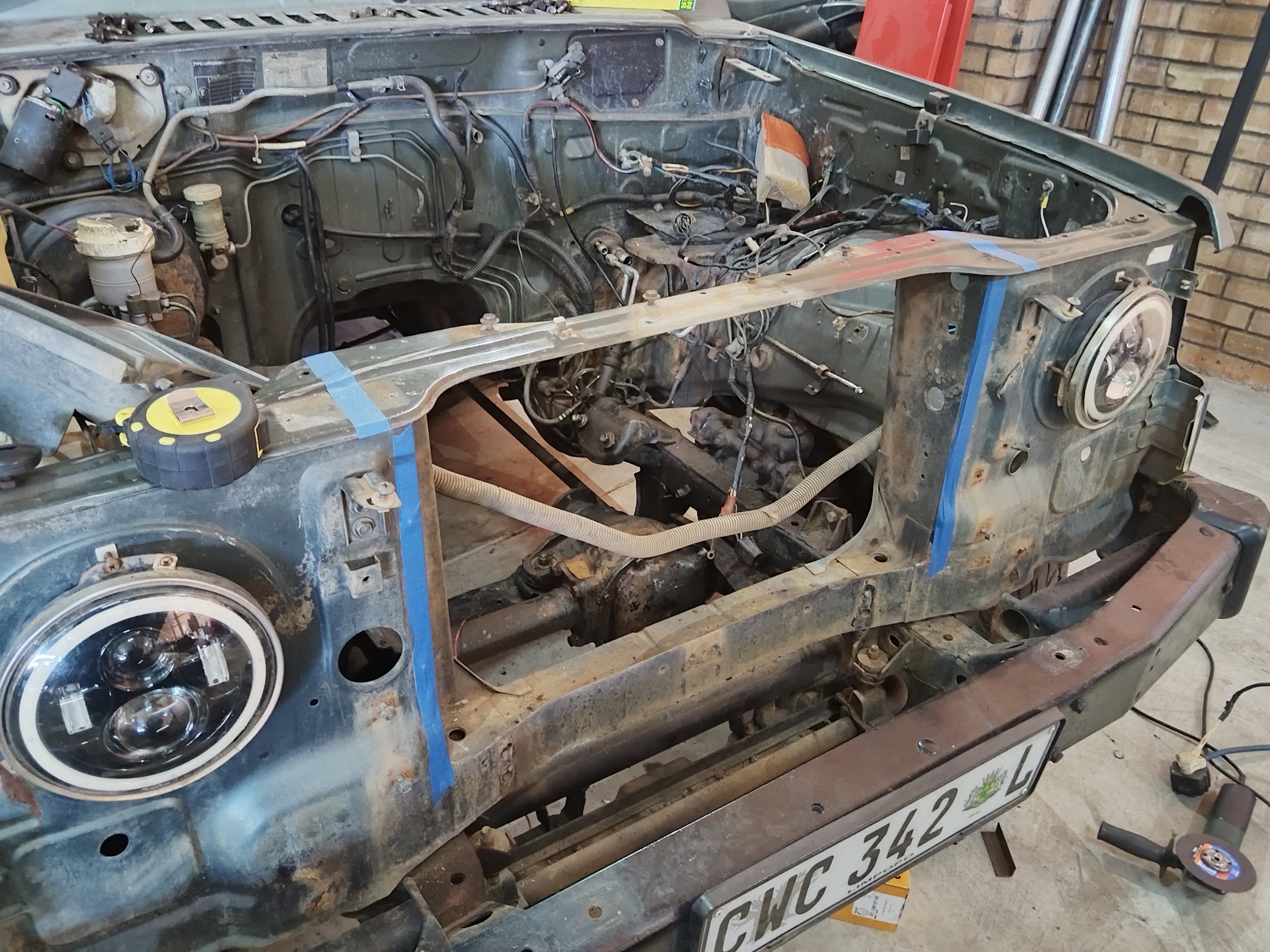

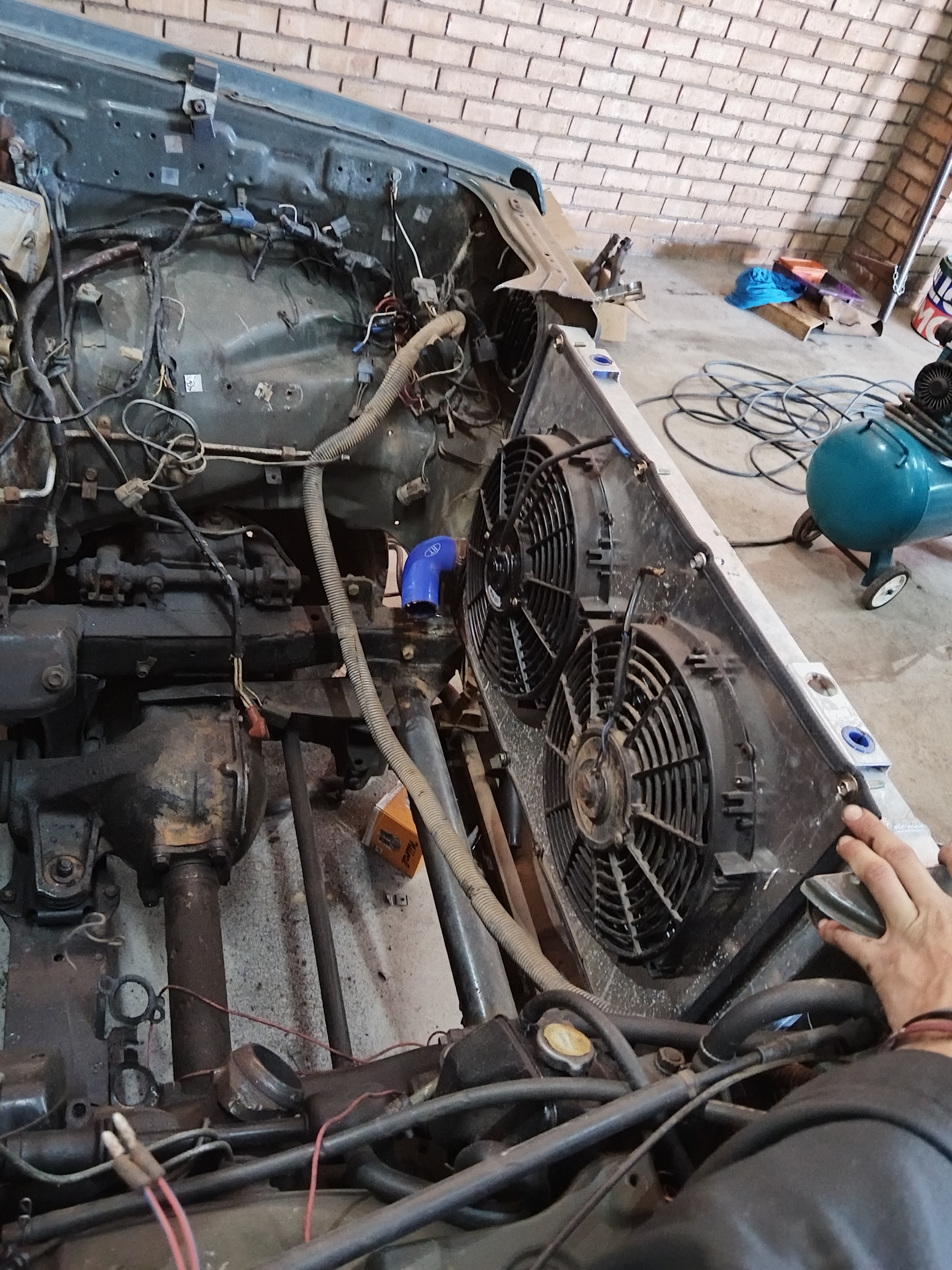

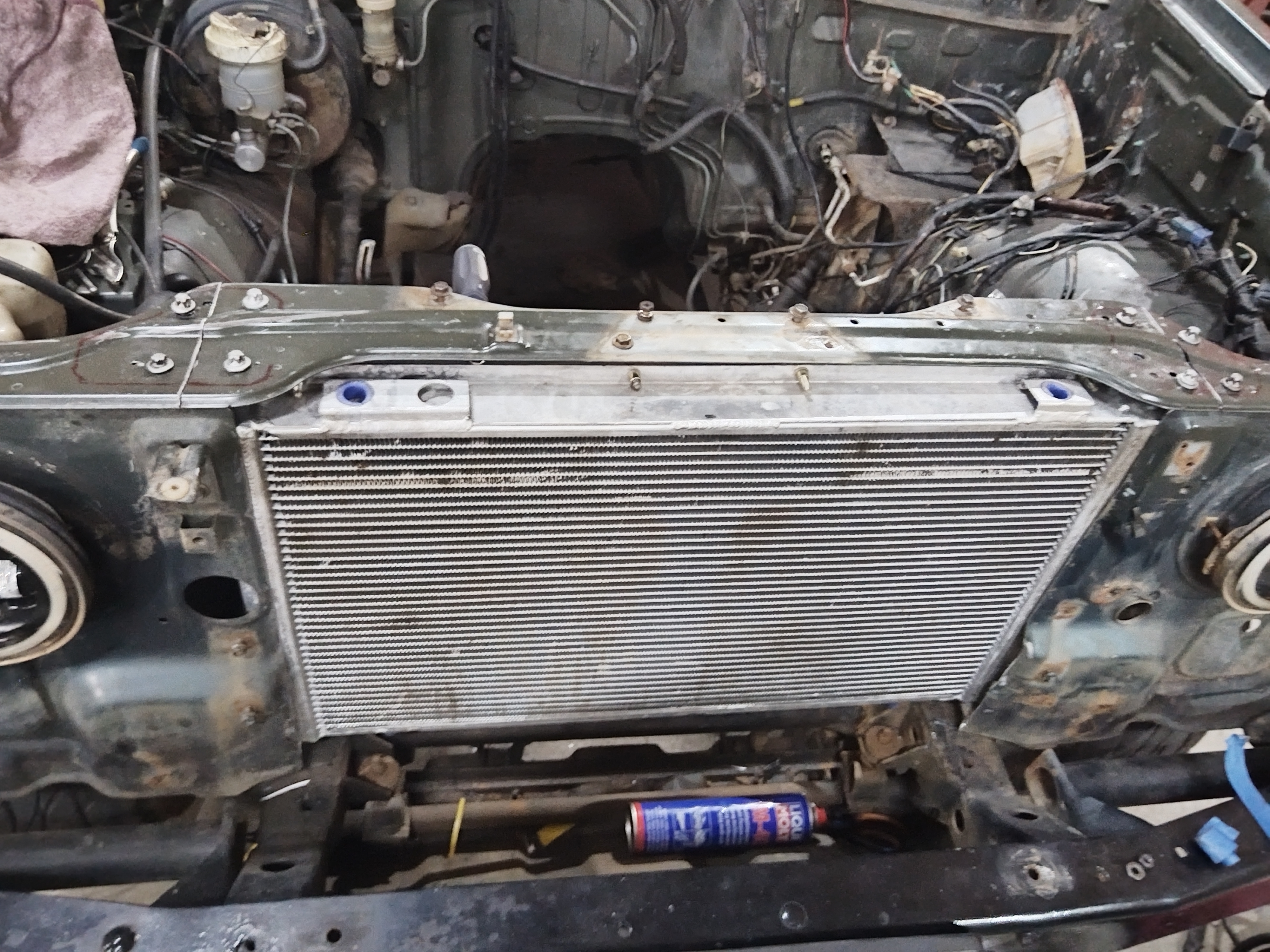

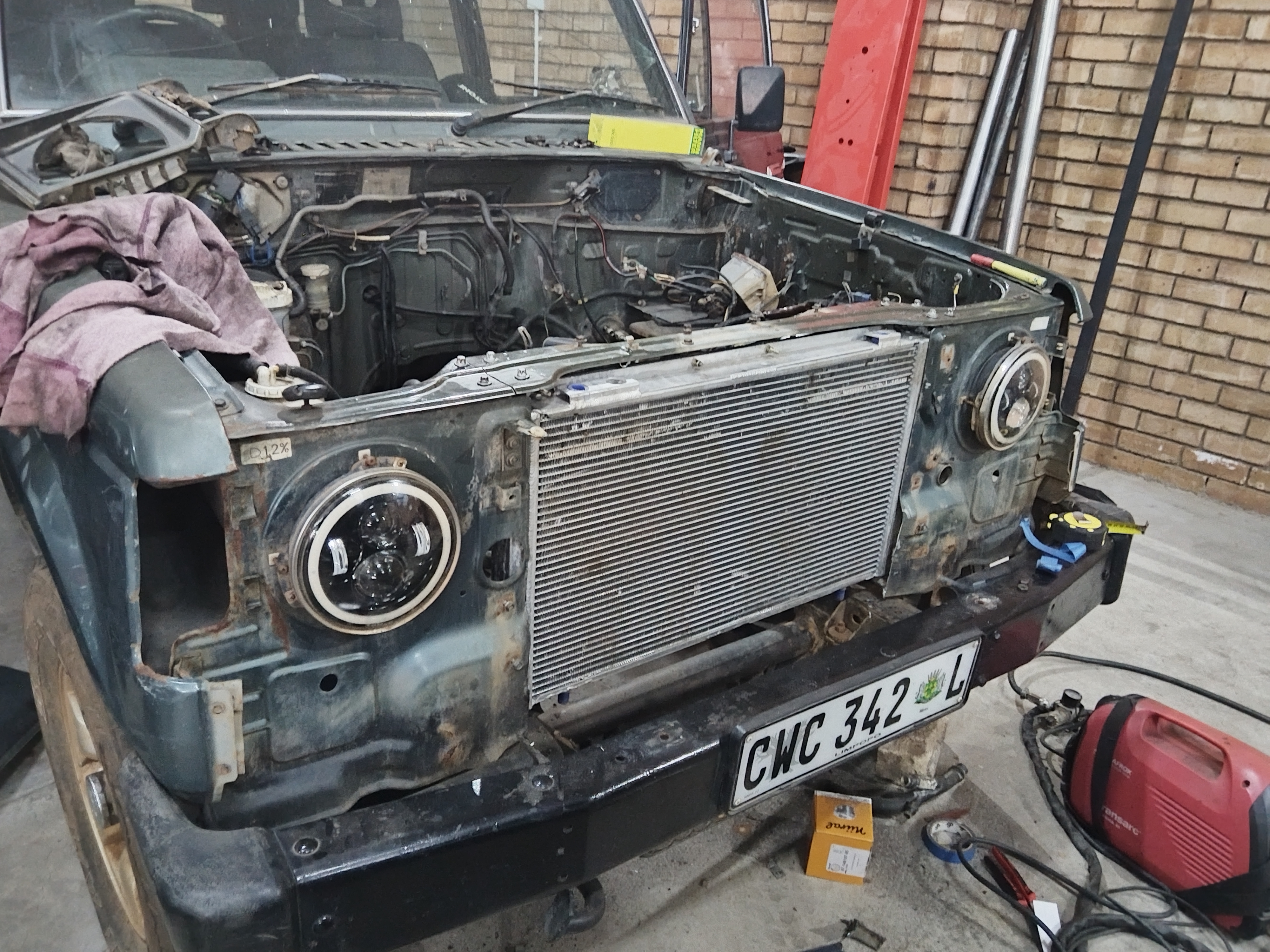

I the took an angle grinder to the virgin body and made room for my radiator, im going with a big aluminum radiator to avoid heat headaches.
I moddified the top core support so that it is now detachable.

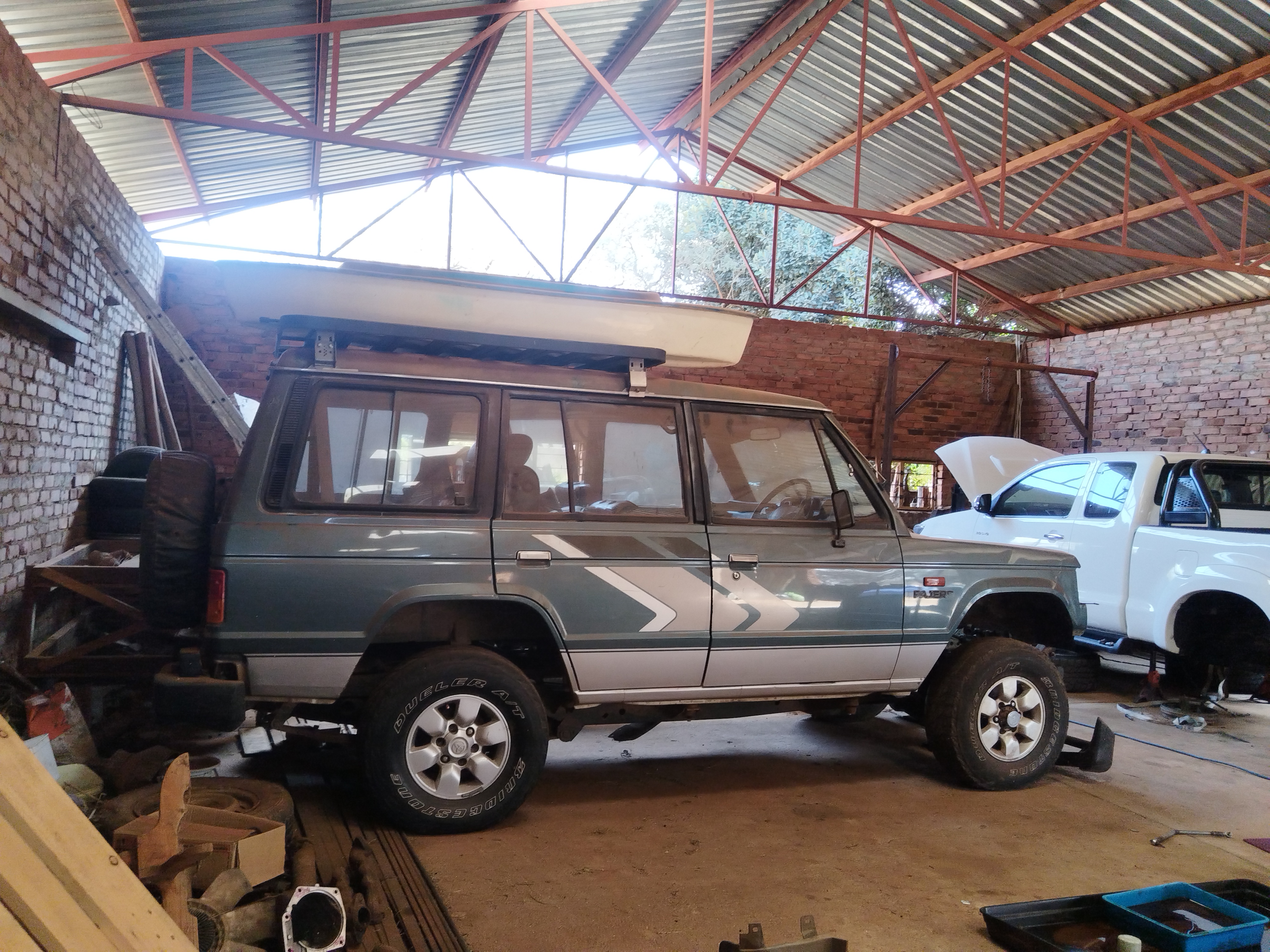

I have also since fabricated some chunky engine mounts, i am just finishing up some maintenance on the engine then i will be putting it back together and back in for the final time. I have had to do a bit of cutting, combined with the 70mm body lift( still have to shim and finish installing) means there is alot of room for activitys such as future repairs/ upgrades.
