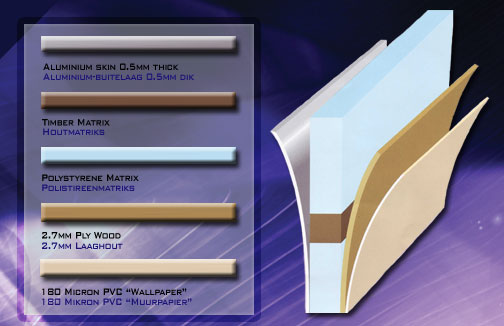

Just a quick pic on the typical construction of a caravan side wall. Acording to loftus this is the same for on and off roaders.
As for your requirements for the interior we are on a similar frequency. In all but one of my vans I have had a full bathroom. It is not so impractical and if you build one in yourself you can eliminate the problems with moisture and water damage. A full set of water tanks as well as a decent shureflow pump on a pressurized system together with a bowen gas/220 geyser is a must. I prefer to have the bathroom in the caravan as the weef can use it on the road while traveling and in case of foul weather one is a bit more protected. We often go just for a weekend and then it is a case of just pulling out the awning and we are settled. I also like the idea of the galley inside for the same reason. Often one sleeps over while traveling and it is handy to have access to some coffee at a picnic spot without having to rig the whole thing.
Your question regarding size- I would look at something not too big as you are quite correct in assuming that the bigger ones have more flex as well as handling problems in rough roads. I would opt for something in the line of the Explorer size as in my opinion that is ideal
