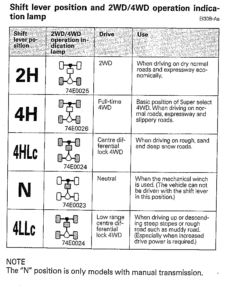

Here's what the Gen 2 handbook says:
Personally, I use as much of the 4WD technology as possible - without being silly (eg. difflock on hard surfaces) of course.
I know it is less economical, but also that it is safer.
