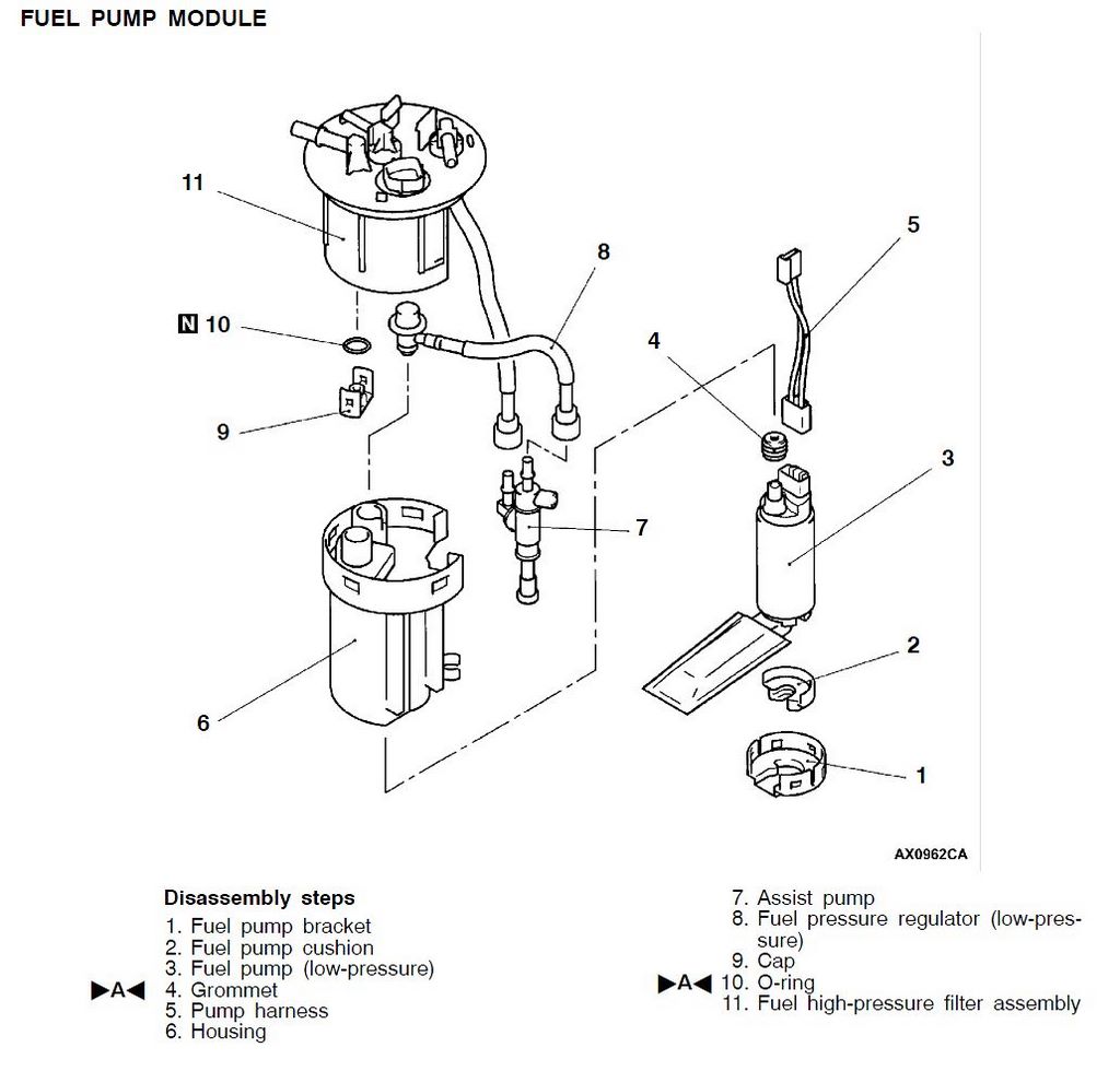

James wrote:Hi Gerrit, This pump assembly seems to have its own cover held down also by some small bolts. If I look under this cover would I see the fuel filter. What complications or things should I know when chaging this filter? Thanks
James, this should give you an idea of what goes on inside the fuel pump module:
Gerrit Loubser Image

Hi Gerrit, Thanks again! Sorry since your last post I had to dash off. I am going to bother you one more time. So is it part number 11 that I would have to replace. I was expecting an inline fuel injection fuel filter?? Is this the only fuel filter on this vehicle and as I say should I purchase part number 11 as a replacement? Is there anything else I should replace? Do Gud filters manufacture an equivalent? If so do you know the part number I should order? Thanks a lot for all this info.
