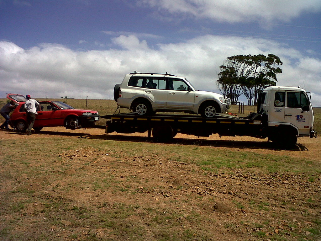

Paj booked in, praying I'll still have her back tomorrow - precious holiday running out..
Hi Cats,CATS wrote:At just over 200 000km on the manual transmision I would also have the retaining plate checked and replaced. Mine started slipping out of first gear every now and again at around 210000km and from the gearbox guy they seem to be prone to start this around this mileage. See this post : https://www.pajeroclub.co.za/forum/view ... ning#p6421
Vehicle currently at dealer, box still not out. Technician scheduled to do another service first. Asked workshop managed to check the points you and Gerrit mentioned. Says they routinely replace the rear crankshaft seal.
He says they don't adive you to open and strip the gearbox unless there's something wrong. Told him what I read on the forum. He said if retaining plate were giving problems it would start with a whine. (Didn't see that in you related thread though).
So, again choices. Would prefer having it done preventatively. Time is also a bit of an issue - they're sqeezing me in at the workshop and I was really hoping to be able to get back to my family tonight if they manage to to fix problem in time.
Any suggestions as to what I should do ?
