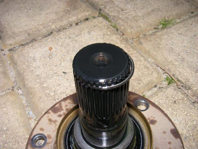

Gen 3 rear differential companion shafts pull-out issue.
OK, I will post all the inforamtion I have gleaned here for posterity in case some of the link don't work in a few years time.
Issue:
Companion shafts pull out of rear diff when loaded or towing.
Look like this:
Probable cause:
Bumping the suspension through to bump-stops when heavily loaded and/or towing causes the shaft to move out of the diff about 10-15mm due to a sub-spec circlip used in the factory, thus causing it to leak varying amounts of oil depending on how far out it has moved out of the diff. It cannot fall out completely due to the length of the drive shaft attached to the wheel hubs keeping it in place.
