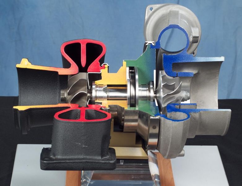

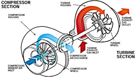

A turbo consists of a shaft with two impellers on it, one on each side.
The one impeller is driven by the exhaust gasses (this is the turbine).
The other impeller (driven by the turbine shaft) compresses the input air (this is the compressor)

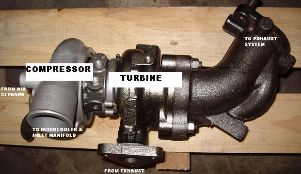

This is what the Di-D's turbo looks like:
Mitsubishi 3.2 Di-D turbo

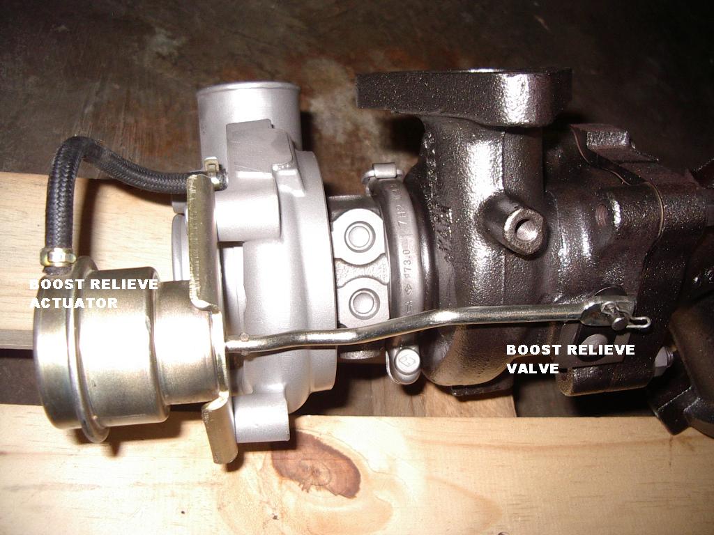

The amount of boost is regulated by a mechanical boost relief system. It simply wastes some boost once the pre-set boost figure is exceeded:

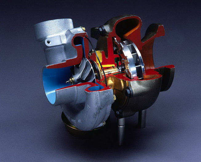

These two images show the innerds:
Each of the turbine and the compressor thus have an inlet and an outlet side.
If you now look at the original photographs again, it is clear that it is the compressor impeller that is FUBAR

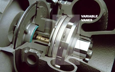

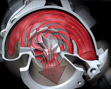

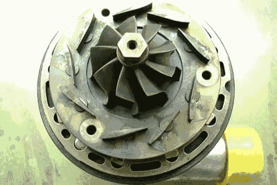

Variable Turbine Geometry technology is the next generation in turbocharger technology where the turbo uses variable vanes to control exhaust flow against the turbine blades. See, the problem with the turbocharger that we’ve all come to know and love is that big turbos do not work well at slow engine speeds, while small turbos are fast to spool but run out of steam pretty quick. So how do VTG turbos solve this problem?

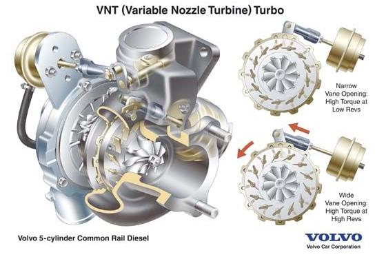

A Variable Turbine Geometry turbocharger is also known as a variable geometry turbocharger (VGT), or a Variable Nozzle Turbine (VNT). A turbocharger equipped with Variable Turbine Geometry has little movable vanes which can direct exhaust flow onto the turbine blades. The vane angles are adjusted via an actuator. The angle of the vanes vary throughout the engine RPM range to optimize turbine behaviour.
In the illustration above, you can see the vanes in a angle which is almost closed. I have highlighted the variable vanes so you know which is which. This position is optimized for low engine RPM speeds, pre-boost.
In this cut-through diagram, you can see the direction of exhaust flow when the variable vanes are in an almost closed angle. The narrow passage of which the exhaust gas has to flow through accelerates the exhaust gas towards the turbine blades, making them spin faster. The angle of the vanes also directs the gas to hit the blades at the proper angle.
Above are how the VGT vanes look like when they are open. I’ve not highlighted where the vanes are in this image since you already know where they are, as to not spoil the mechanical beauty that it is.
This cut-through diagram shows the exhaust gas flow when the variable turbine vanes are fully open. The high exhaust flow at high engine speeds are fully directed onto the turbine blades by the variable vanes.

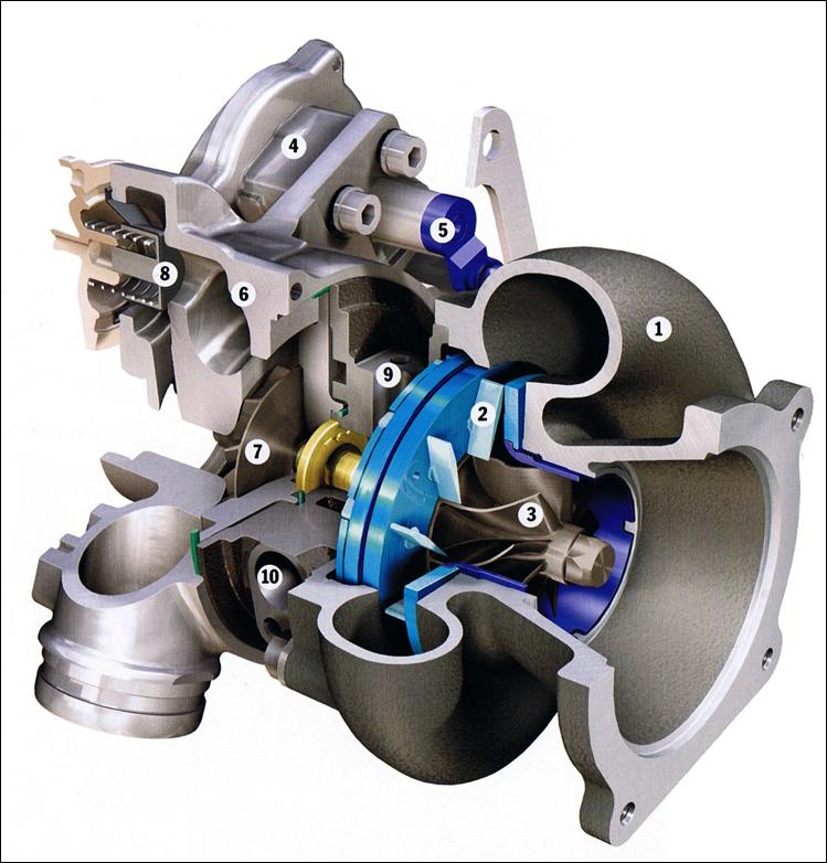

Summary
Here it is all put together:

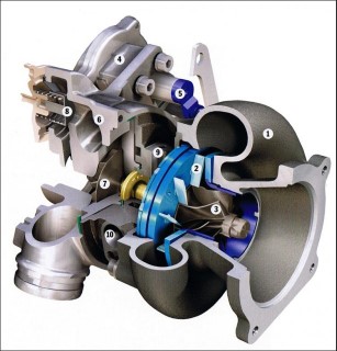

Overall, the turbo thus looks like this.
  • (1) Turbine casing,
  • (2) Movable guide vanes,
  • (3) Turbine wheel,
  • (4) Electric motor for guide vane adjustment (where installed),
  • (5) Guide vane adjuster,
  • (6) Compressor casing,
  • (7) Compressor wheel,
  • (8) Excess pressure valve,
  • (9) Oil inlet,
  • (10) Coolant inlet.
More good reading here
