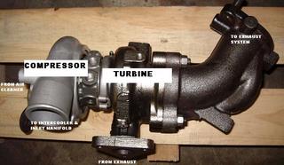

This is what the Di-D's turbo looks like:
Mitsubishi 3.2 Di-D turbo
The amount of boost is regulated by a mechanical boost relief system. It simply wastes some boost once the pre-set boost figure is exceeded:

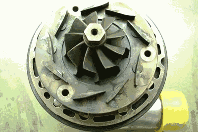

These two images show the innerds:
Each of the turbine and the compressor thus have an inlet and an outlet side.
If you now look at the original photographs again, it is clear that it is the compressor impeller that is FUBAR

Summary
Here it is all put together:
Overall, the turbo thus looks like this.
  • (1) Turbine casing,
  • (2) Movable guide vanes,
  • (3) Turbine wheel,
  • (4) Electric motor for guide vane adjustment (where installed),
  • (5) Guide vane adjuster,
  • (6) Compressor casing,
  • (7) Compressor wheel,
  • (8) Excess pressure valve,
  • (9) Oil inlet,
  • (10) Coolant inlet.
More good reading here

4ePajero wrote: If you now look at the original photographs again, it is clear that it is the compressor impeller that is FUBAR
Thanks for this. So if it is the compressor side, what your are saying is that the Exhaust Gasses and even the boost had nothing to do with the failure. I am starting to understand this thing a bit better now. So it seems that Roelf's concern about the intercooler might be valid, as this is the next item in the process?
Why would the shaft have damage? According to the photos and explanantion earlier on, this is caused by loss of lubrication due to old or contaminated oil. Will this be the cause for that?
Does a turbo needs to be serviced in any way to prevent failure, like say new bearings etc? When will the time be for that? Or does one leave it alone until it makes funny noises?

CATS wrote:Thanks for this. So if it is the compressor side, what your are saying is that the Exhaust Gasses and even the boost had nothing to do with the failure.
Yes, although the failure occurred at high boost (rpm) by the OP's admission. The high boost caused a high suction in the inlet, which most probably picked up a pebble / sand grain from the air cleaner housing.
CATS wrote:I am starting to understand this thing a bit better now. So it seems that Roelf's concern about the intercooler might be valid, as this is the next item in the process?
The intercooler is a radiator, which in this case acted like a strained and this could very well have saved the engine, if we assume that the pieces are stuck in the intercooler.
Yes, I would remove the intercooler and service it (which is a good idea in any case).
CATS wrote:Why would the shaft have damage? According to the photos and explanantion earlier on, this is caused by loss of lubrication due to old or contaminated oil. Will this be the cause for that?
Shaft movement is usually only a function of kms (wear) and bad oil, but an incident like this could have cuased additional damage.

Dirty oil? Every 7500km I service the Pajero at the agents and I don't think dirty oil can be the cause of this failure.
Since asking the question on the internet, how long should a turbo last, I have had feedback from 3 Pajero owners and their turbos lasted to approx. 180000 km's?
I did a dune trip last year October between Luderitz and Saddlehill. Your theory of a sand grain can be valid. However before we returned home, I did remove the air filter to check for sand and found nothing. This trip was between 188500km's and 195000km's. The Pajero was serviced at 195000km's, no turbo whistle. The whistle started just before the next service at 203500 km's (was suppose to be done on 202500km's)
The fins shown are on the side going into the intercooler/engine. The fins at the exhaust side are ok.
