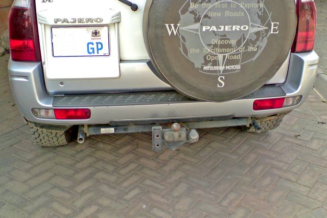

For what it's worth if you have a gen3.
Henk Bannink
Won't mounting the hi-lift on the spare wheel cause extra load and wear on the door hinges? The jack weighs a ton
Yes, it does, but in the absence of a roofrack or bull/nudgebar, that is probably better than fixing it to the (thin) steel of the body, eg. Robin's fitment:vvandam wrote:Won't mounting the hi-lift on the spare wheel cause extra load and wear on the door hinges? The jack weighs a ton

- The weight of the spare wheel (and jack) is only of concern when the rear door is open. In this situation the weight hangs on the hinges. (I think the brackets are OK for the static load)
- Once the door is closed, the weight is supported by both the hinges and the lock mechanism. Dynamic loads are thus not all on the hinges (unless you drive with the door open)
- dynamic loads are exerted on the bracket (and thus the door panels).
- It is a mute point what dynamic loads are exerted on the bracket, hinges and lock mechanism:
- the shock load is cushioned by the suspension and tyres
- the height of any 'jump' will rarely exceed 1m.
- I think the constant vibration / shaking is most likely to damage the brackets and panels, rather than the hinges and lock.
