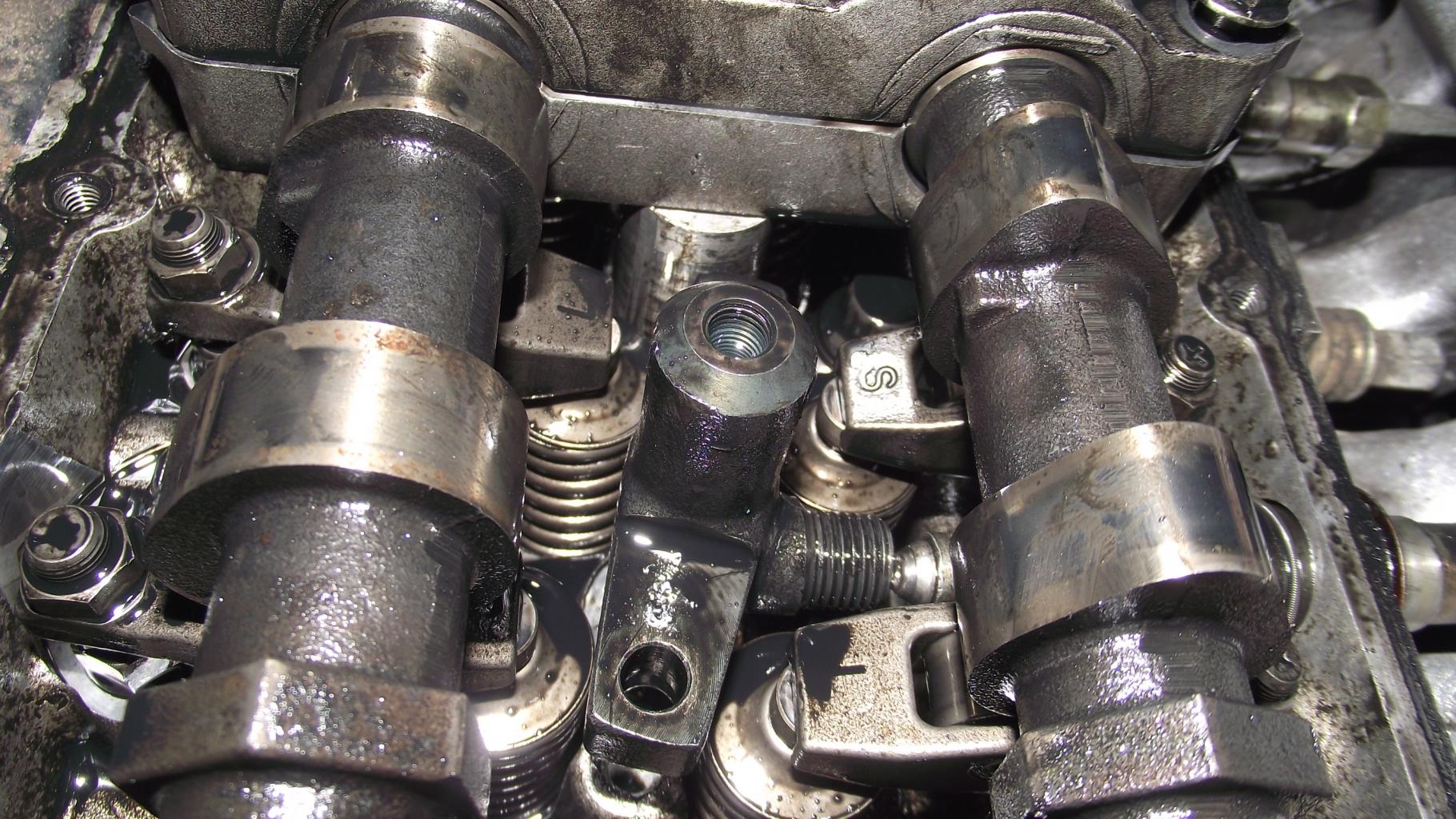

I started stripping but can't get the injectors out. The manual shows that they are just in there and the only things holding them in is the 2 bolts that II removed as per picture below.
Any advice? If I can't get them out I'll have to skip that step and just do the valve stem seals.
