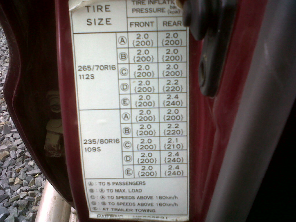

This is the sticker on my Gen3.
Either stick with manufacturer recommendation or change to your own preferences (but realize the repercussions)
NOTE that some insurance companies may null and void your claim if the tyres are not the OEM spec - not to mention a law maniac that may sue you in case of an accident.
