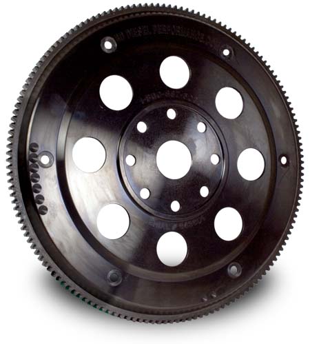

Got some feedback that it might be a flywheel from automatic gearbox. Then it will not work??? I am not to clued up with auto gearboxes and flywheels.

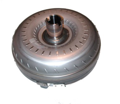

autoboxes don't use flywheels. They use the inertia of the torque converter (bolts to the engine output shaft via a flexplate).
Ok, my old Passat had a torque converter but could not recall what it bolted on to. I assume the flex plate is not made from solid metal(cast iron)and does not look the same as flywheel?

Strictly technically speaking, a flex plate can be seen as a 'flywheel', but I would not rate that article very high, especially for clarity.
An automatic transmission is coupled to the engine by means of a flex plate and a torque converter.
The Flex Plate: The flex plate serves the following purposes:
The Torque Converter: The torque converter is bolted (rigidly) to the flex plate, and transfers engine torque to the auto transmission.
- It connects between the torque converter and the engine's crank shaft.
- On it perimeter it has a ring gear, which meshes with the starter motor (a manual transmission's flywheel has a similar ring gear)
