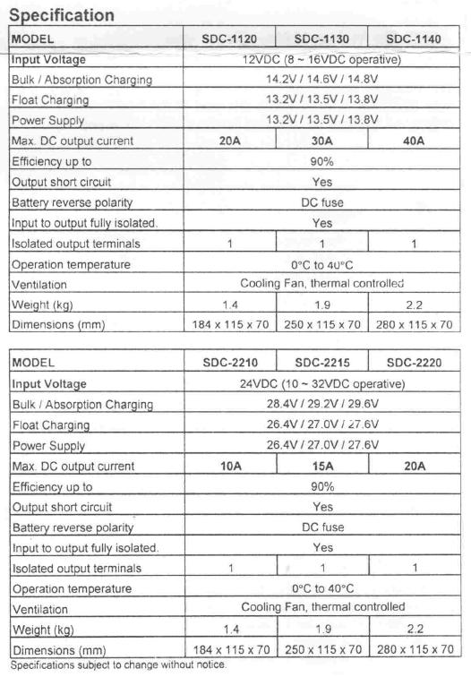

Ok, anyone know of these guys?
http://www.cornerstonepowerproducts.co. ... 0-Amp.aspx
One thing I am unsure of - the output voltage on many of these seem to be 13.8, but I though that charging voltages for our purposes should be around 14.2 to 14.4 volts. Is 13.8 sufficient?
