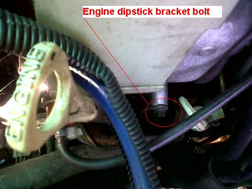

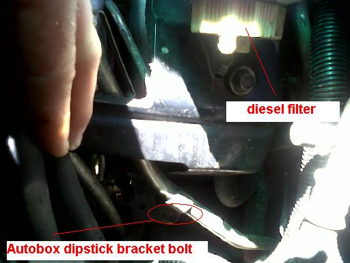

Maybe slightly off topic, but is this dipstick supposed to vibrate with an amplitude of about 2 to 3cm?Nismo wrote:
Just want to make sure, the dipstick is the one behind the engine oil dipstick???
No. Your bracket is probably missing or not bolted down.Gemaskerde Tuinvurk wrote:Maybe slightly off topic, but is this dipstick supposed to vibrate with an amplitude of about 2 to 3cm?Nismo wrote:
This is the supporting bracket bolt for the autobox dipstick and the engine dipstick supporting bracket bolt.
