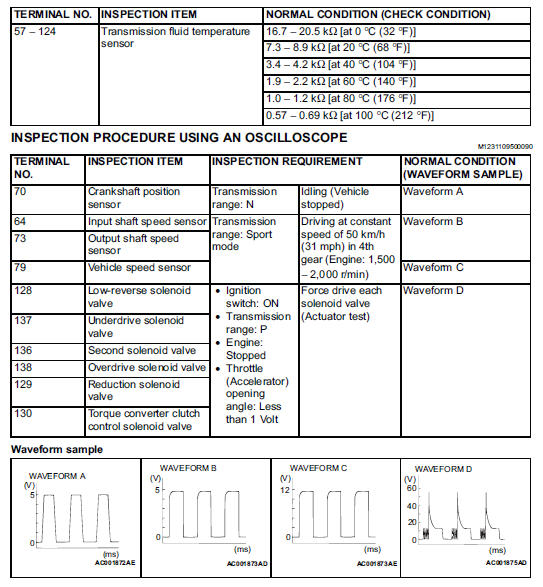

No. It actually saves the lock up clutch plates. In stock form the ecu sends a PWM signal to lock up which means that there is always some slip on the clutch plates even under lockup.
With the lock up DIY mod you send an effective 100% PWM signal that locks the clutch packs 100%.
See the pajero workshop manual extract regarding the PWM signal to the TCC.
I also attach a brochure explaining the workings of a PWM TCC.
