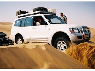

2000
2000

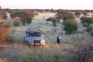

2003
2003

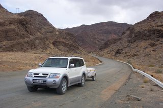

2006
2006
Gerrit,
I agree with your "many subtleties" comment.
The big differences from 2000 to 2003 were: light arrangements front and rear - including the round foglights.
The 2003 had the 6 disc shuttle in the dash and the much larger and more comprehensive colour console display.
By 2006 the T/C and sunroof was added and the 3.5V6 made way for the 3.8V6. By 2006 the beige leather was pretty common in the GLS models. The 17" rims were also fitted to the post 2003 Pajeros
