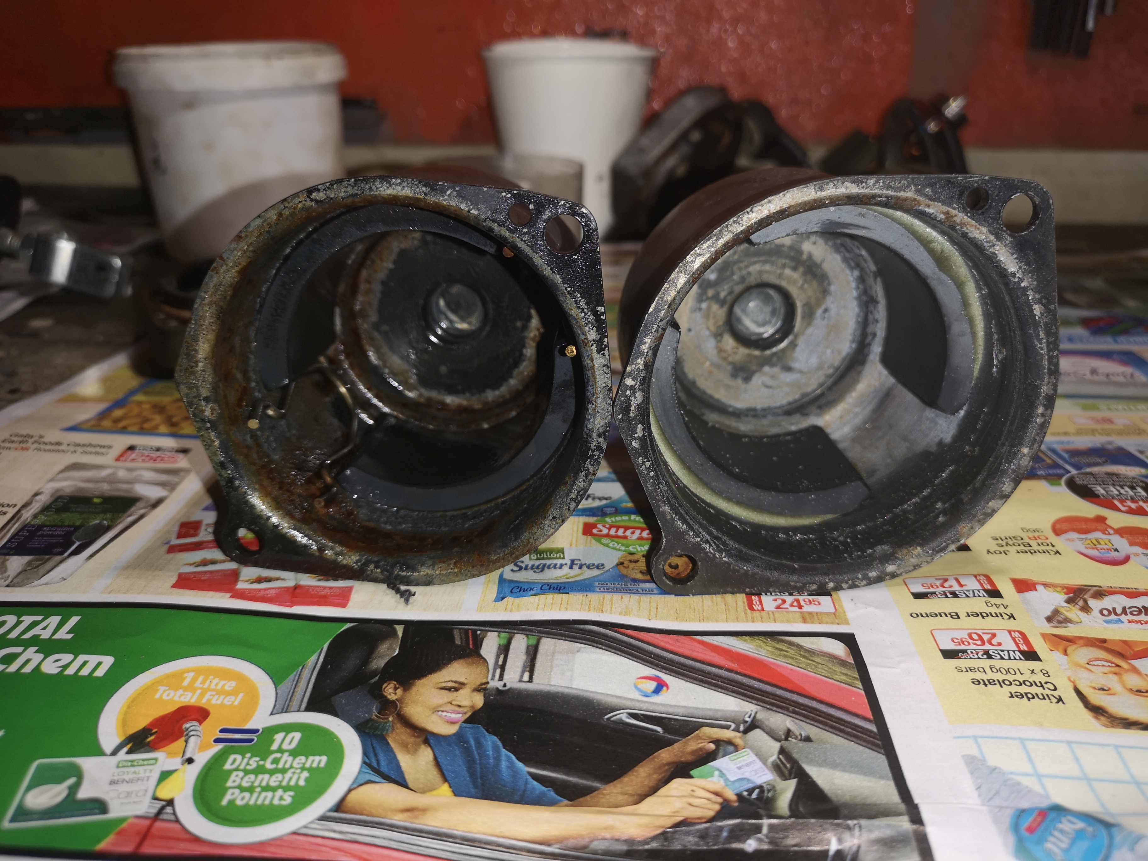

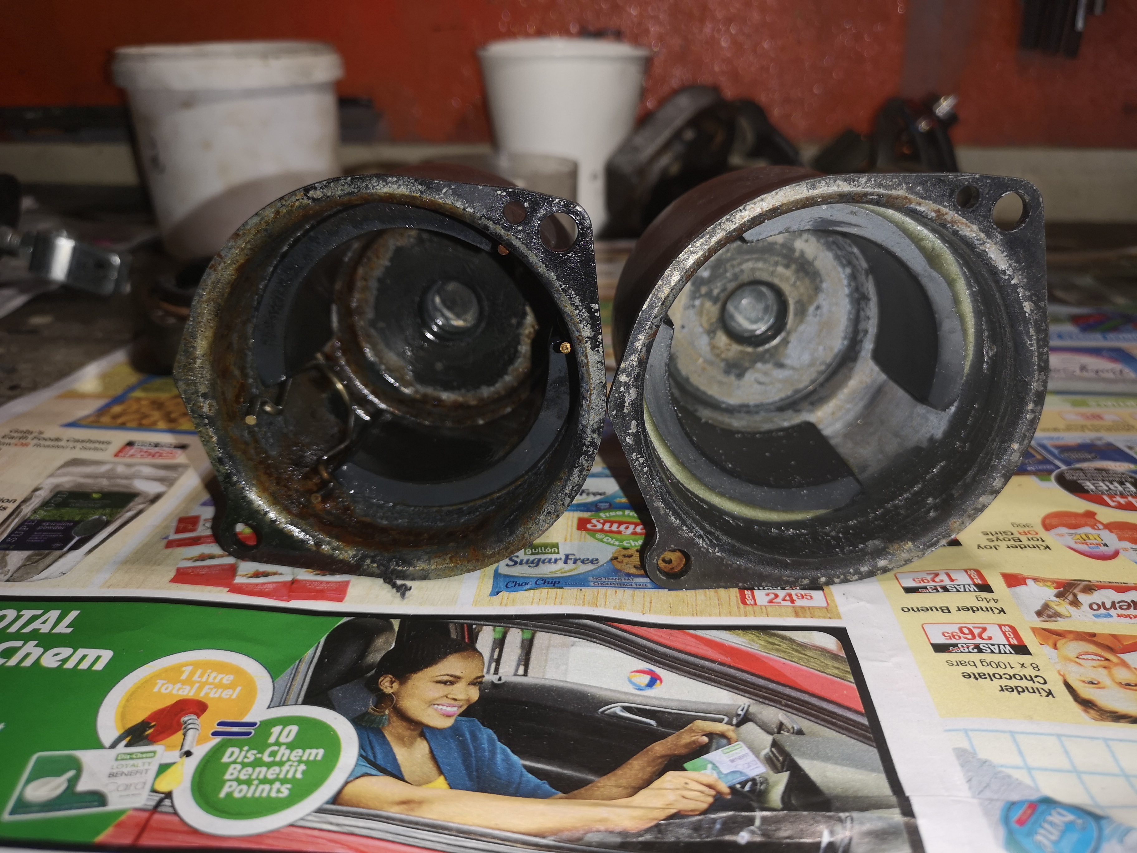

I took the external casing with the magnets from the stuffed motor and put that on my motor. Put it together and it worked!!
One thing I noticed between the two casings with the magnets:
The casing from the bought spare and my casing, the magnets that were re-epoxied onto the casing, the placing of the magnets does not match the magnets of the donor spare casing I got (original). Would this cause the motor to not perform 100%? As just with the casing change it seems to be 100%. They have the same gap, but are about 30 degrees out.
