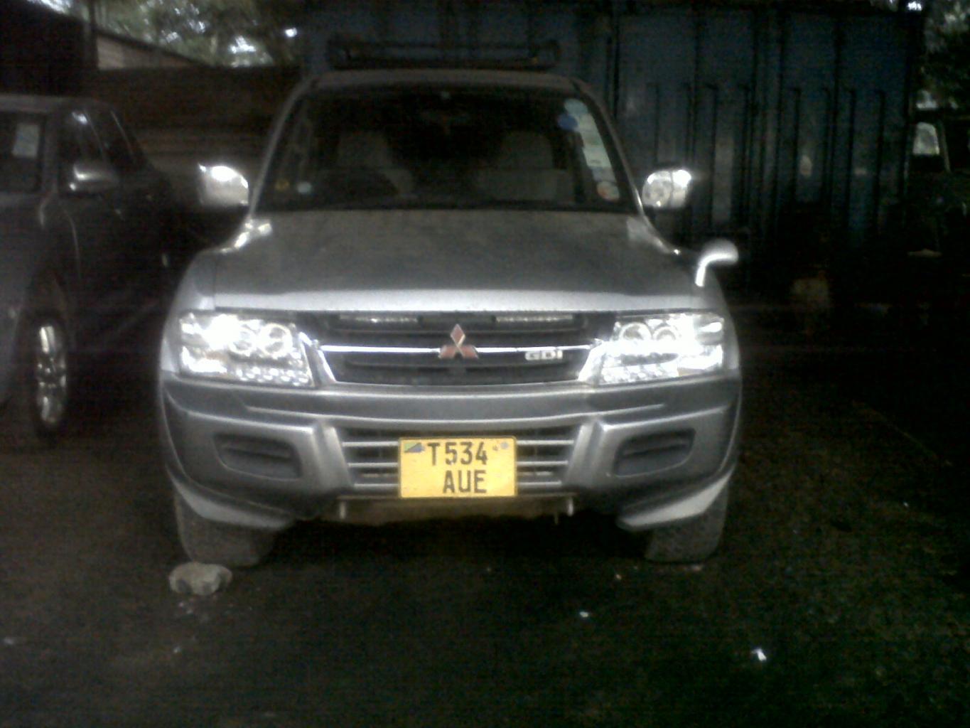

Hi Brian/Balsaid
I have
Mitsubishi Pajero GDI
GH-V75W
Pajero - LRUCQ1 Exceed-S, 4FA/T complectation
Full frame number V75W-0012016
"Option
" Exterior Interior Manufacture date
U3HB 20A 2000.03.3
Sounds like I have a very similar problem as yours (and balsaid) with my 3.5 GDI 6g74. Can you please send me the name/number and any details of your fundi in Dar?
I've worked my way through 3 different fundis already, all of whom have succeeded in creating more problems than the last.
Thanks & regard
Abdul Masood

I don't have this model truck, but a great attachment Brian.
Well done.
Well done.
